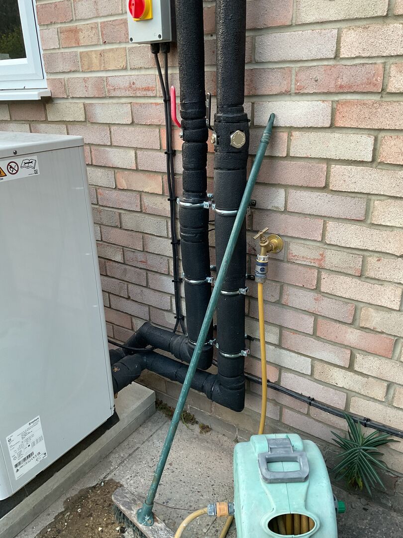

Had a new Vaillant 7kw installed with new 28mm runs for primaries and flow and return. I’ve got a variable pitch humming sound that resonates through the house depending on how hard the heat pump is running. Admittedly this is just a test run I’m doing tonight but it worries me as i can hear it above the TV.
one thing my plumber who ran the 28mm’s did do was clip them against the wooden ceiling trusses. Could this be transferring noise into the house? With the old boiler setup and pump you could only really hear the pump where the pipes were exposed in the kitchen just below the pump in the cupboard above.

Its possible that the clipped primaries are transferring noise. I do have some clipped 28mm primaries also but only in the utility room and garage (where they split into 2*22mm - the original pipework). This could depend on exactly how they are clipped
I presume that installer has fitted flexible pipework for the final metre or so to the ASHP and that the ASHP is on proper rubber feet.?
* exception - during recovery from defrost when compressor is at 100% I can just hear the compressor indoors. The unit sits <1m from the room in which I hear it adjacent to a window and the noise transfer is airborne.
Roof trusses and dry lined ceilings are a massive sounding board. This is a very common issue with sparks who screw bathroom extract fans direct to roof trusses - they sound like a helicopter is landing on your roof! Use rubber lined vibration resistant pipe clips and that will help hugely. External circulating pumps are usually supported by the copper piping, and vibration gets transferred into the piping and from there into the fabric of the house. Also, with a new system, you may have a higher flow in the primary pipework than the system flow requirement, and that could be generating noise due to high pipework velocities.

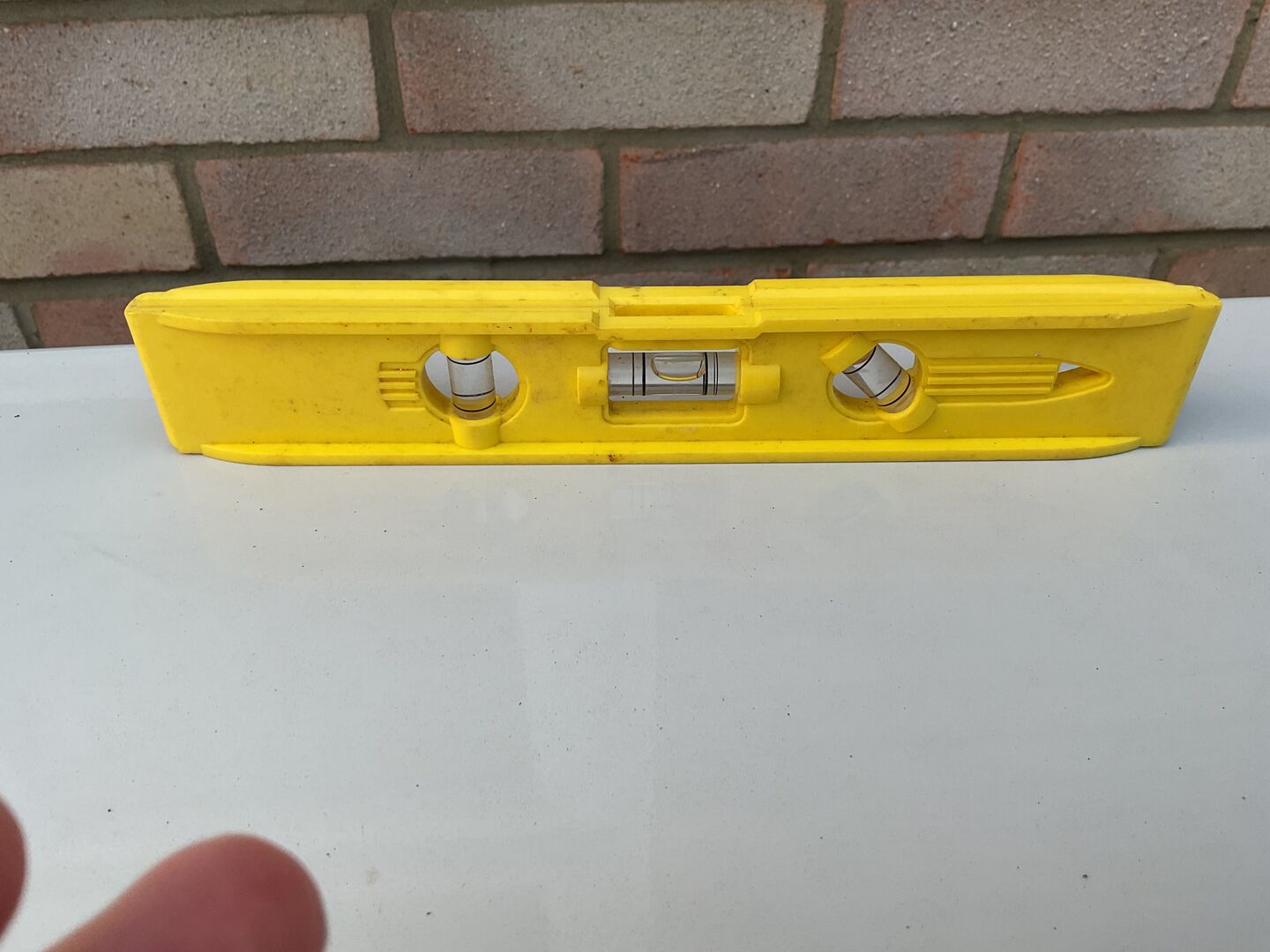

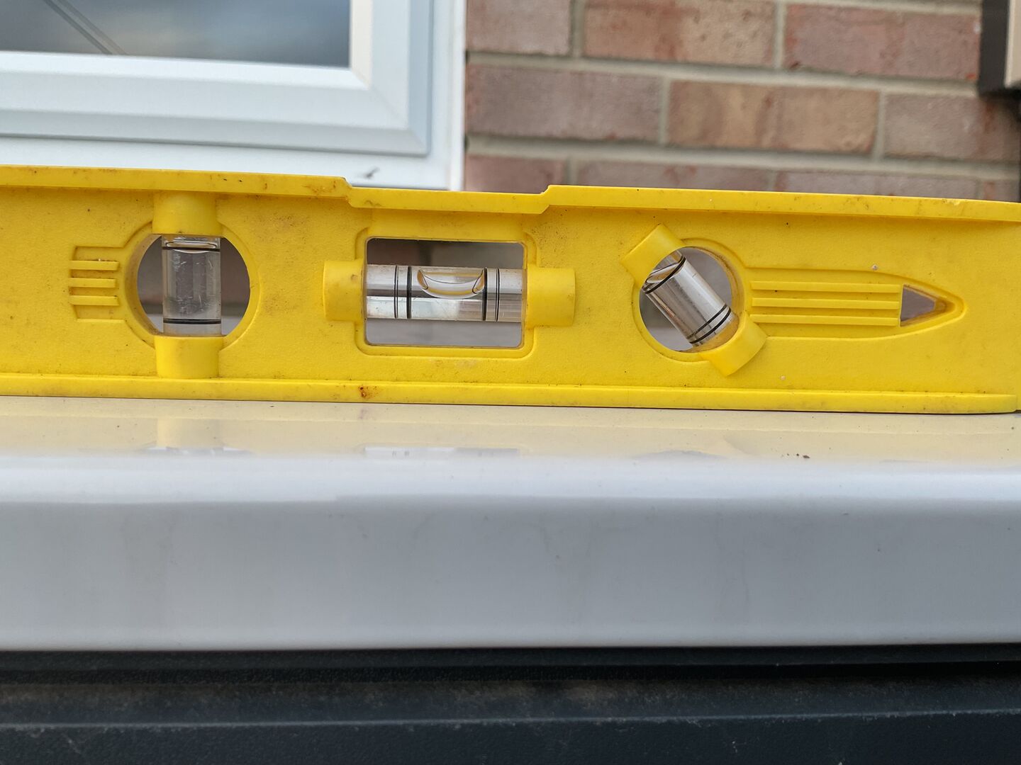

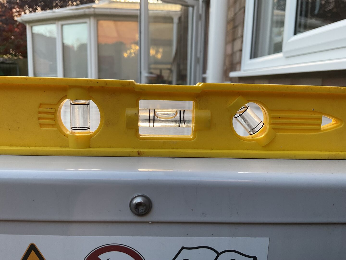

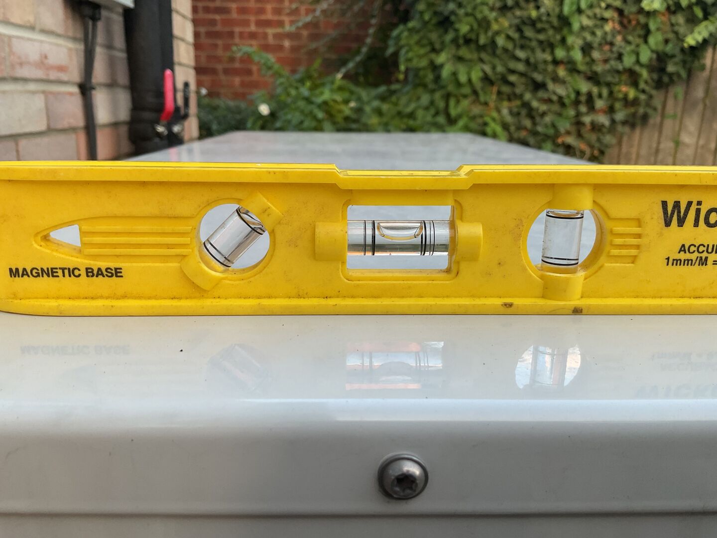

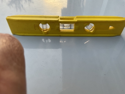

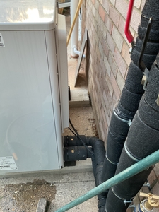

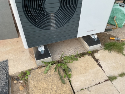

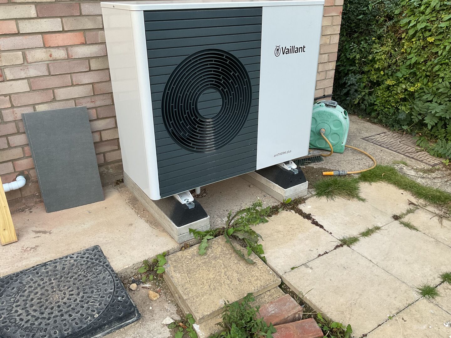

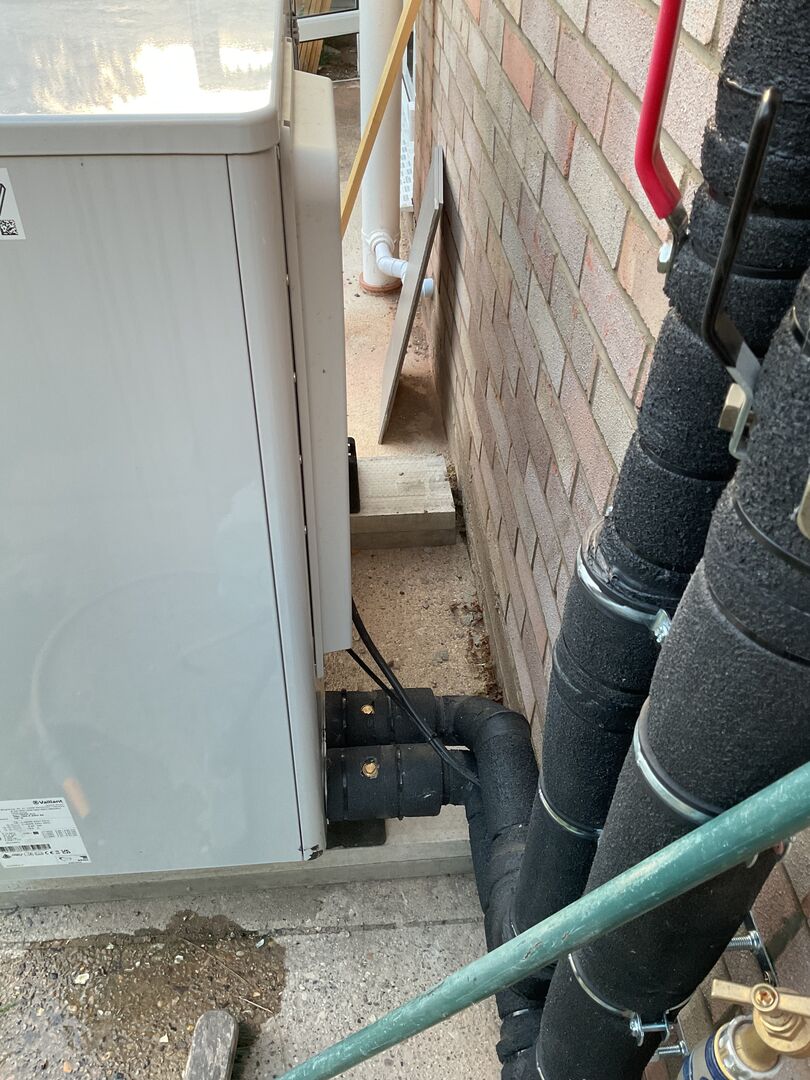

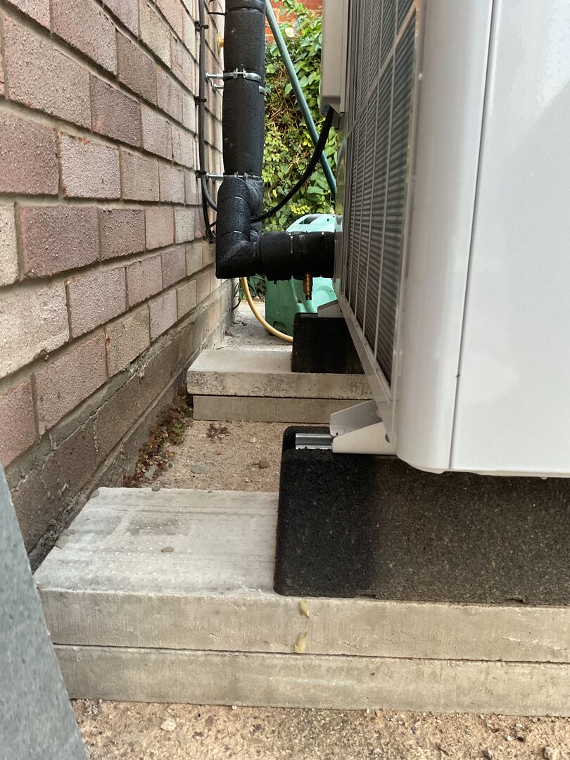

Levels don't look terrible and it appears they cast concrete bases so i would have through these would be level?
so the wall clips are holding the flex to the wall?
