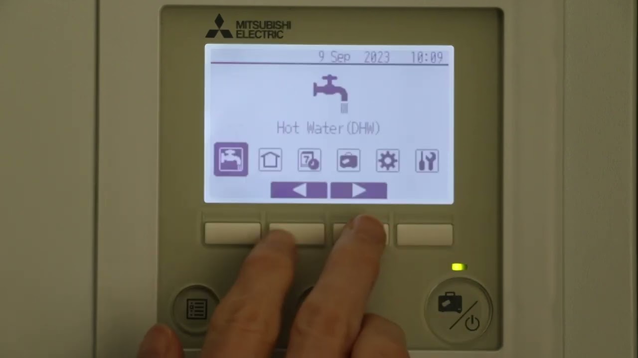

Thx for replies. I am aware that HMI (Main RC as it is called in manuals) can be removed from the box (and that it can be used as a room temp. sensor).
Current placement:
I think that settings are correct:
(this is "Show temp:" and Room+DHW)
(this is "Setting for room sensor" and selected is "Main remote")
Room temp. is visible via MELCloud. But on the main screen it is not:
(it should be left from the DHW temp)

I recorded video with settings and behaviour (and I changed UI to English before 🙂
As far as I can see everything that you suggested is already set.
Posted by: @damijandI recorded video with settings and behaviour (and I changed UI to English before 🙂
I missed this before but you need to put the system in room temp mode to display the room temp. Yours is on weather compensation and in that mode the room temp isn't displayed.
Oh really (I knew that there is some stupid thing). Big thanks for this. - I tested it and it works.
