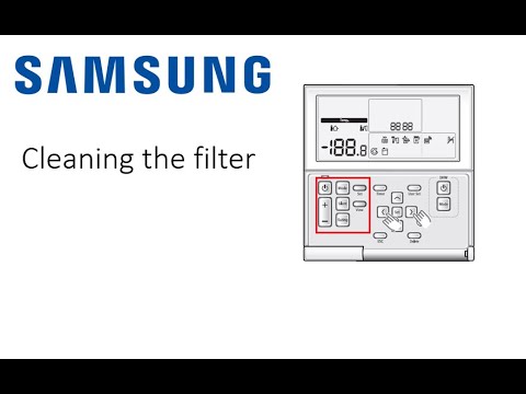

@northumberland this is a video from freedom on how to clean a Samsung HP filter.
https://www.youtube.com/shorts/UMRlW-ersiA
as a note, if you are hunting for that filter, it should be on a big bore pipe returning to you ASHP and it should be inside the house (but it could be outside)
@batalto Many thanks for this video - will go and check if we seem to have anything that looks like that on the system
@batalto many thanks the two pics show the system - didn't look to have any obvious filter valve that I could see - my own plumber (spoken to him) is convinced it doesn't have any other filter than the BOSS magnetic filter
