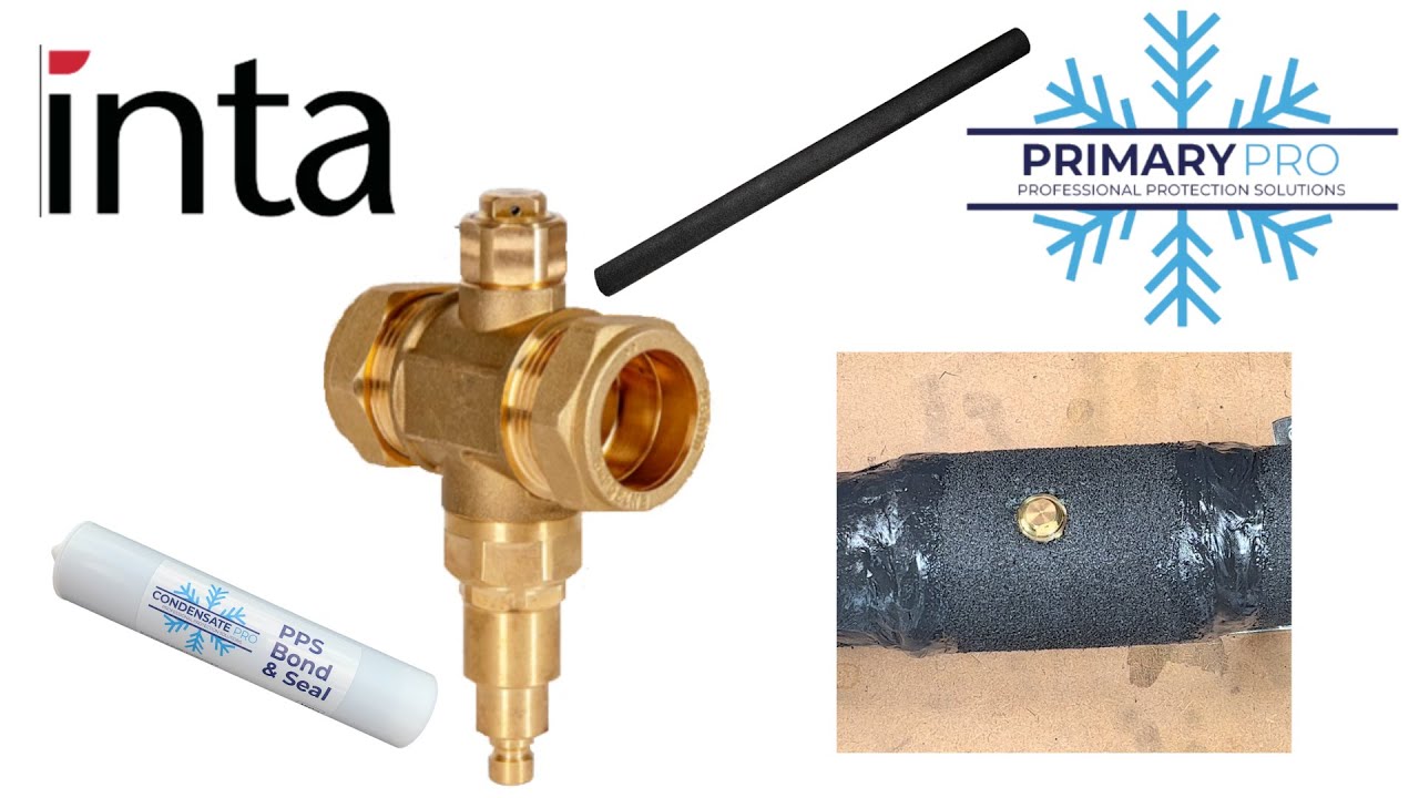

@dannymoss23 so they've used the proper method as far as I can tell to get out  the garage wall to the ASHP (big hole, insulation through hole, pipe through insulation. They need to be encouraged to do the same to get the pipes the bedroom.
the devices outside with the gaps in insulation are anti-freeze valves. they are not done correctly, they should not have as much exposed to the air as they have. primary pro is your bible yet again (its not exciting but it really is worth looking at)
you should also check if they are sheltered from precipitation or drips from other parts of the house. Basically if ice or snow should form or sit on top of them , they will open (acting as though the system has frozen up) and start draining down that part of your system. They are there as a last-resort only so they need to be protected from weather.
