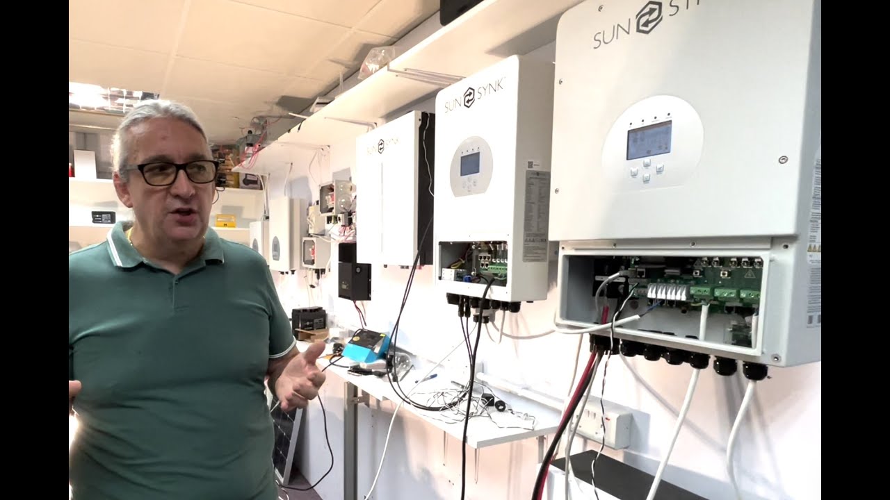

EDIT: I think this actually describes my situation:
So keep both inverters. Interesting.
