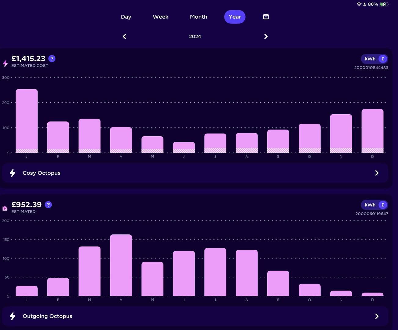

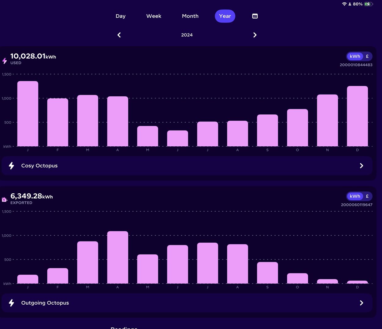

@old_scientist I am attaching the consumption and solar production figures in kWh and in monetary value for last year. Cosy tariff applied along with Outgoing fixed for the export for most if not all the time. (I would need to go back through my bills to be sure.) Regards, Toodles.
