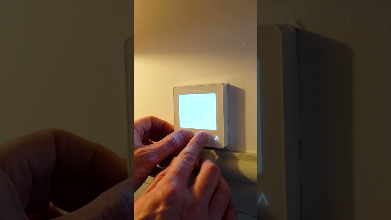

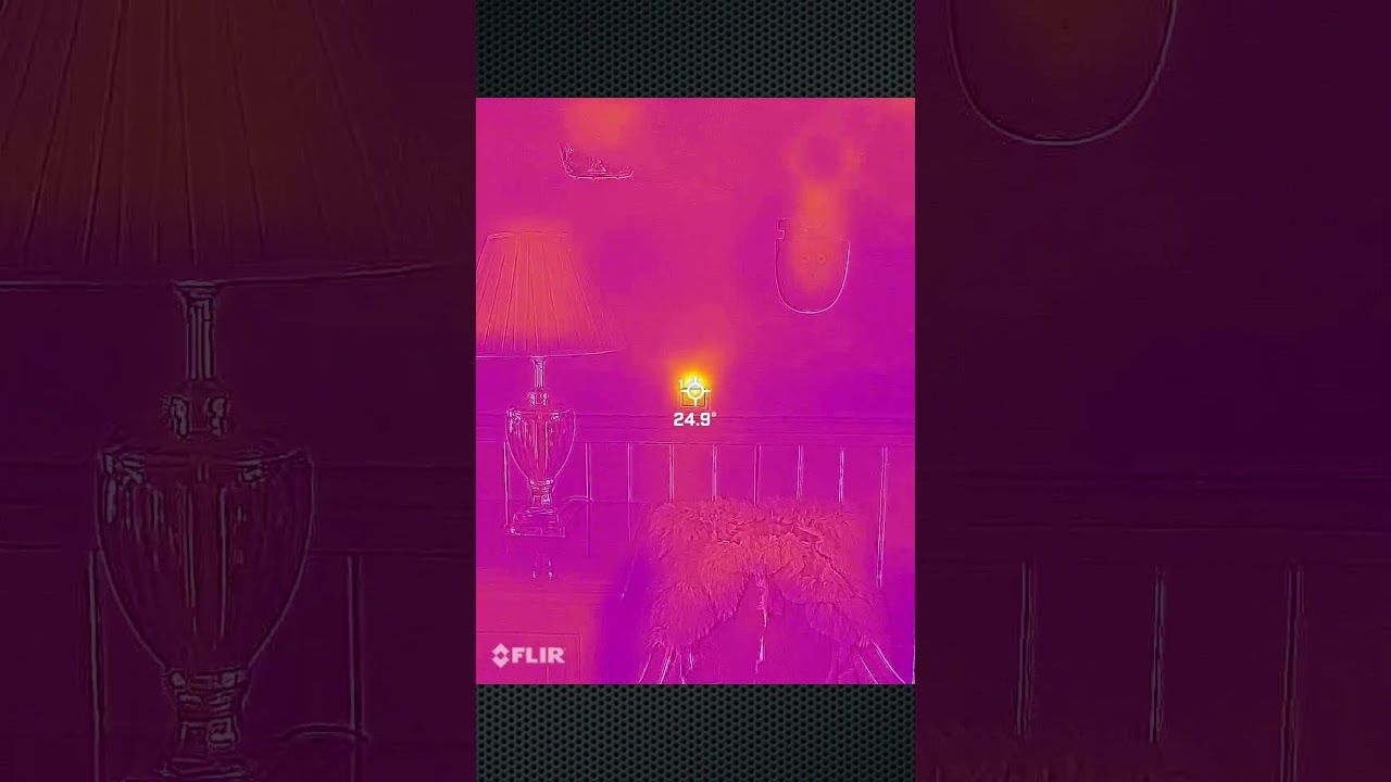

Moving into our home brought the advantage of an already installed underfloor heating system, regulated by Heatmiser Neostats. These devices, promising precise control and energy efficiency, became a focal point of curiosity about their accuracy in temperature regulation after it was raised on a recent YouTube we posted. To assess this, I used a FLIR ONE thermal imaging camera to compare the thermostat readings against the actual environmental temperatures across different heating zones.
The process unveiled unexpected discrepancies between the Neostats’ temperature readings and the thermal camera’s more accurate measurements. Additionally, it highlighted hot spots within the thermostat units, potentially influencing the accuracy of the readings and, by extension, the effectiveness of our home’s heating system.
Motivated by our findings, we recalibrated our Heatmiser Neostat thermostats.
