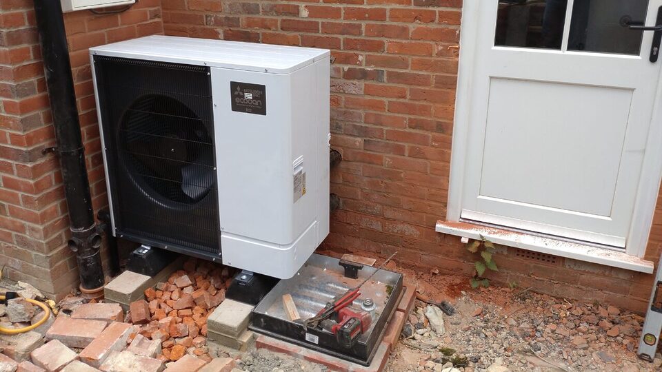

Overall, I’m not impressed with either the installation or the 11.2 kW Mitsubishi Ecodan heat pump that was installed in our home.

There is a bit of a compromise of the placement of the heat pump, (still plenty of space in front and to the side) so when it’s cold and still out the air immediately around the cabinet gets ‘stale’. If it was possible to move the internal thermostat, I think that would help.
Yes I see that which may compromise performance (heat pumps after all rely on taking in ait at ambient temp, not air that they have themselves cooled).  If by the ‘internal thermostat’ you mean the internal (to the outdoor unit) outdoor air sensor sensor, then ideally  this should be somewhere else in the shade.  Only a few heat pump manufacturers do this however.  Often its in the input air stream (so its really an air intake sensor).  Thats probably next best so long as its shaded.
