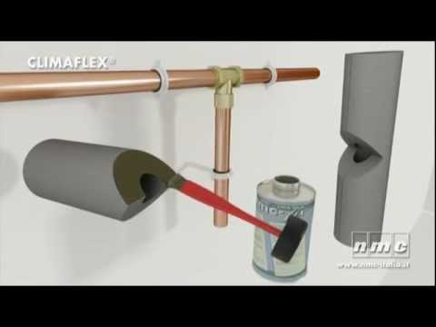

Posted by: @bretixupgrading the lagging as we speak today to find this bodge job. I'm assuming foam filler will help sort this and help with insulation ?
I'm not wildly enthusiastic about the use of expanding foam!
The thickness of pipe insulation in your plant room doesn't look adequate in the first place.
If that was my heat-pump pipework, I'd be starting again and following the relevant manufacturers' online guide.
Here's one from NMC, who make the grey Climaflex often sold at DIY stores:
