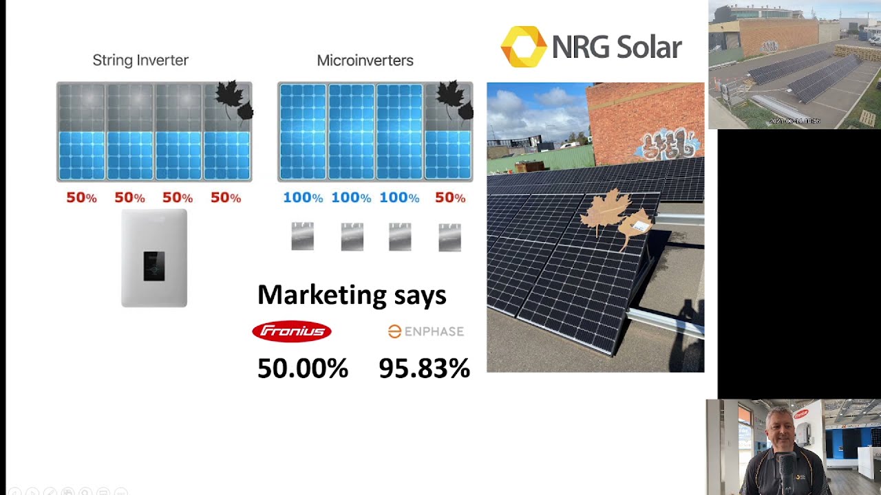

Not sure if this is specific to the string inverter used or more general to modern equipment but I found this interesting from NRG Solar in Australia

@ken I've been looking into a string inverter for two new roof arrays with some slight intermittent shading. I also found this video to be really informative, and encouraging. I would like to avoid optimisers etc up on the roof if at all possible.
The video demo used a Fronius Primo inverter, which uses something called Dynamic Peak Manager. Looking it up it seems to be their version of Global MPPT.
I've been trying to establish how commonplace Global MPPT is in today's solar inverters, as it seems to be a notable benefit when operating a shaded string. For example, I contacted Givenergy about their inverters but the tech support team didn't have any information beyond their datasheet.

That was a gret little demonstration is that vid.

Assuming this is accurate, it seems the simplest summary (anyone feel free to correct me if I'm wrong!) is that optimisers and microinverters are great for maximising output when the shading is diffused and there is essentially still some light reaching all of the cells on the panel (distant tree or cloudy inclement weather) or there's a small shadow (e.g. cable across a panel), but when the shading is heavy and blocking out a cell or more, there's no real difference as was demonstrated in the NRG video.
I agree with your summary, which was very surprising to me as I was always under the impression that the heavier the shading the greater the case for microinverters/optimisers!
