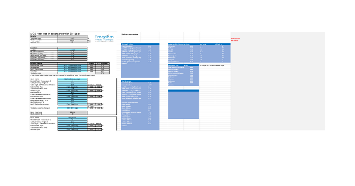

there is a simple one on the site I posted the link for that is customisable.  The Stelrad radiator site has a very comprehensive one that is also customisable.  Both of these sites require you to sign up.
Kev
(@batalto)
Posts: 1092
@warren-s I posted a calculator on here where you can input your own U values. Just have a look

mars/kev thanks for the replies have applied for the freedomhp.one i saw on youtube . once i get that and some figures ill start a thread on my findings a get some advice for what systems may be best .

@batalto many thanks batalto but new here ,where can i find it .

@warren-s this should do you
https://docs.google.com/spreadsheets/d/1HAGXEC7WOhjsmXFf8Noh9CUvafc8E-DvoKn96zehmYc/edit?usp=drivesdk
You'll have to download your own copy as it's read only

@batalto many thanks . i emailed them today , awaiting reply .

@warren-s just go to that link and there is an option to download your own copy. Then you're off

batalto , many thanks . entered all my data on your link after copying for a new project and got a heat loss of 4457w  30wm2 148m2 heated floor space . but when i try and choose any pump on the 2nd sheet it does no populate or change any of the paramiters or energy graph . any ideas guys

dont worry gents just spotted my mistake with an input .
allgood will do a post in next few days ... materials plant etc .
