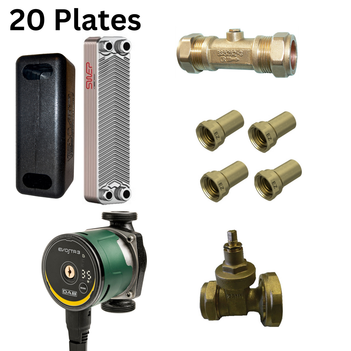

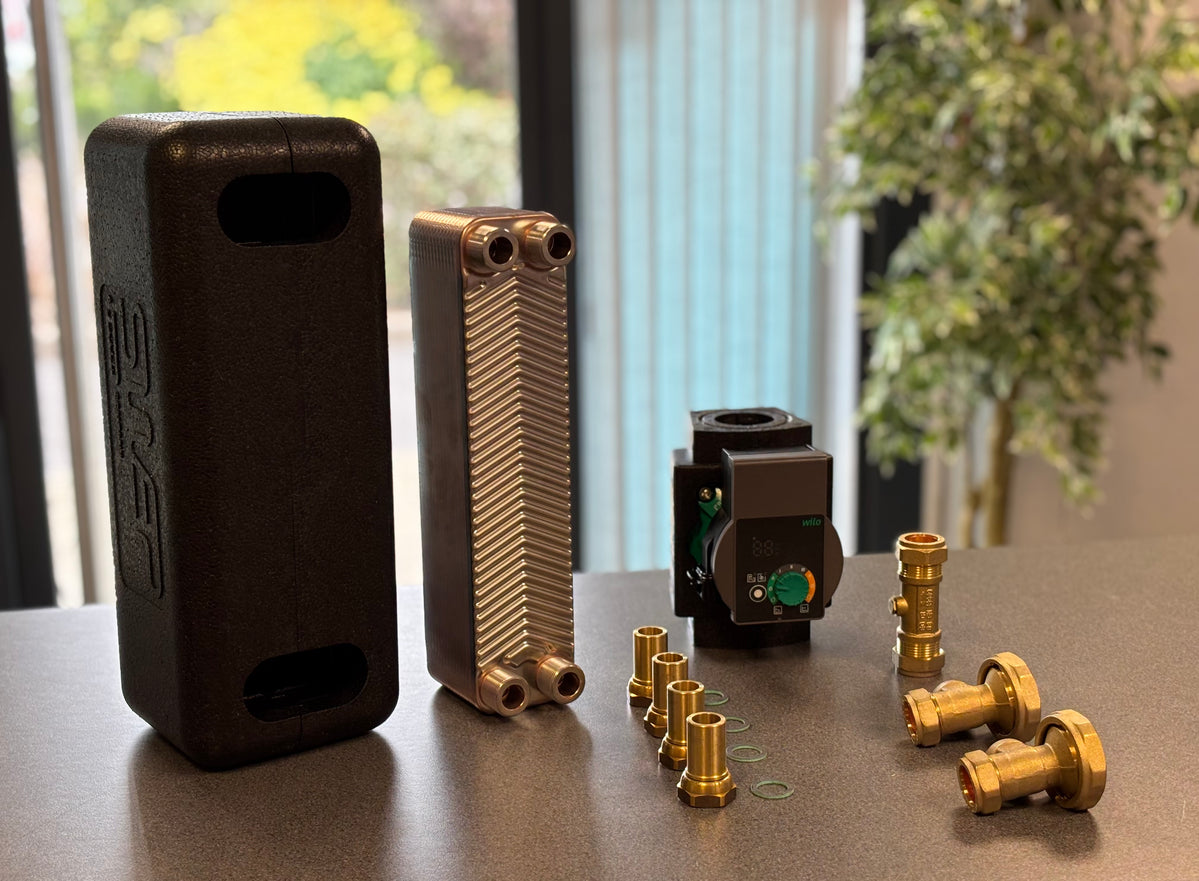

On another forum and in a different context someone (@johnmo who is also on this forum) has just posted this link https://beetbg.com/products/dhw-plate-loading-20xplate-kit
Its designed for DHW (which presumably you also need) but the same principle, and likely the same components, would work for space heating. You may need to find out a bit about the chemistry of the spring water in case its likely to be corrosive.
