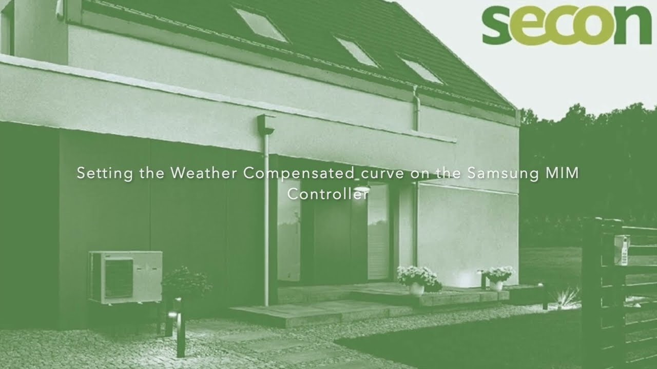

This video seems to match my setup, there are various other videos that tell you how so it's whatever works for you.
From what I know, fully opening the TRV's will be enough, assuming the radiators have already been balanced, i.e. the valves on each turned enough to ensure all radiators get enough flow to reach the same temperature.
