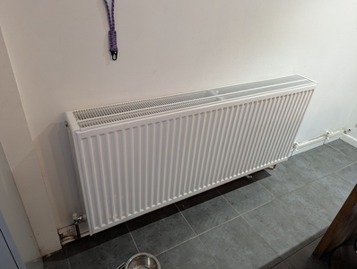

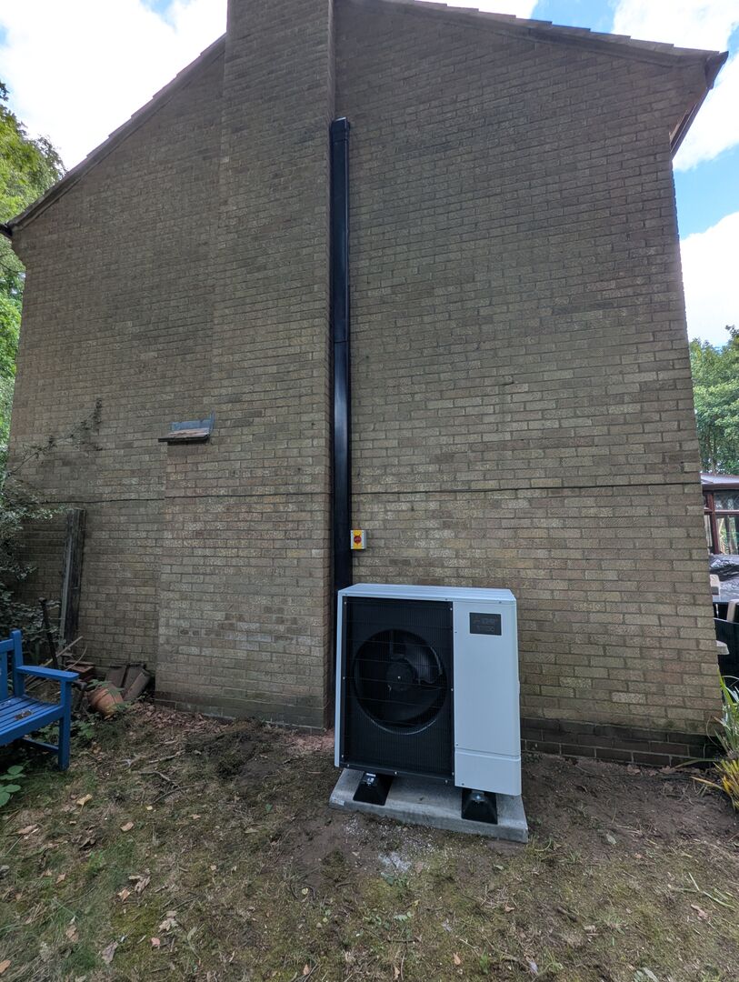

And on the second day, we have a completed installation!
The team finished up at around 6:30pm this evening and my immediate impressions are that I'm very impressed with the job they've done.  We had the two main installers out today, plus the electrician for most of the day and the labourer for a few hours.  The biggest challenge to the entire job appeared to be for the electrician to run the cable from the consumer unit to the cylinder tank and out to the heat pump, as the joists in the house seemed to conspire against him for this purpose.

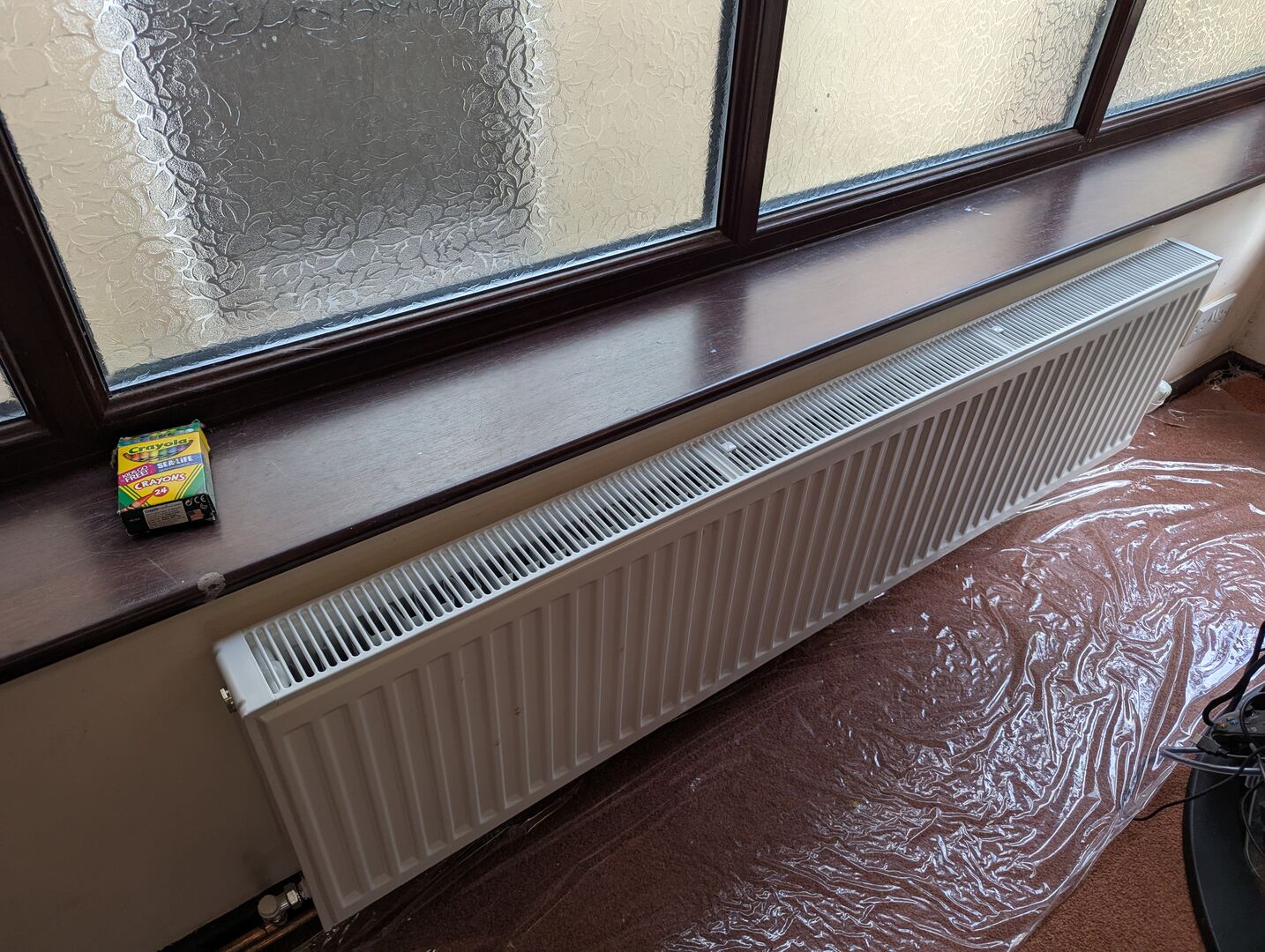

The outstanding radiator was delivered in good time, so we now have a re-sited 2nd radiator in the conservatory running along one of the dwarf walls, and there's no longer one (or any pipework) on a section of wall that will be removed when the conservatory is renovated.

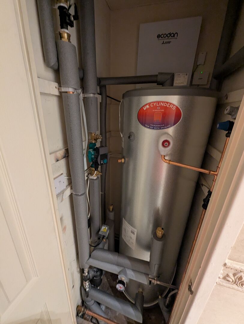

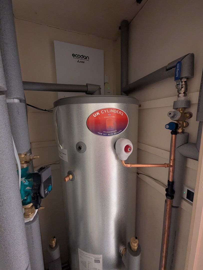

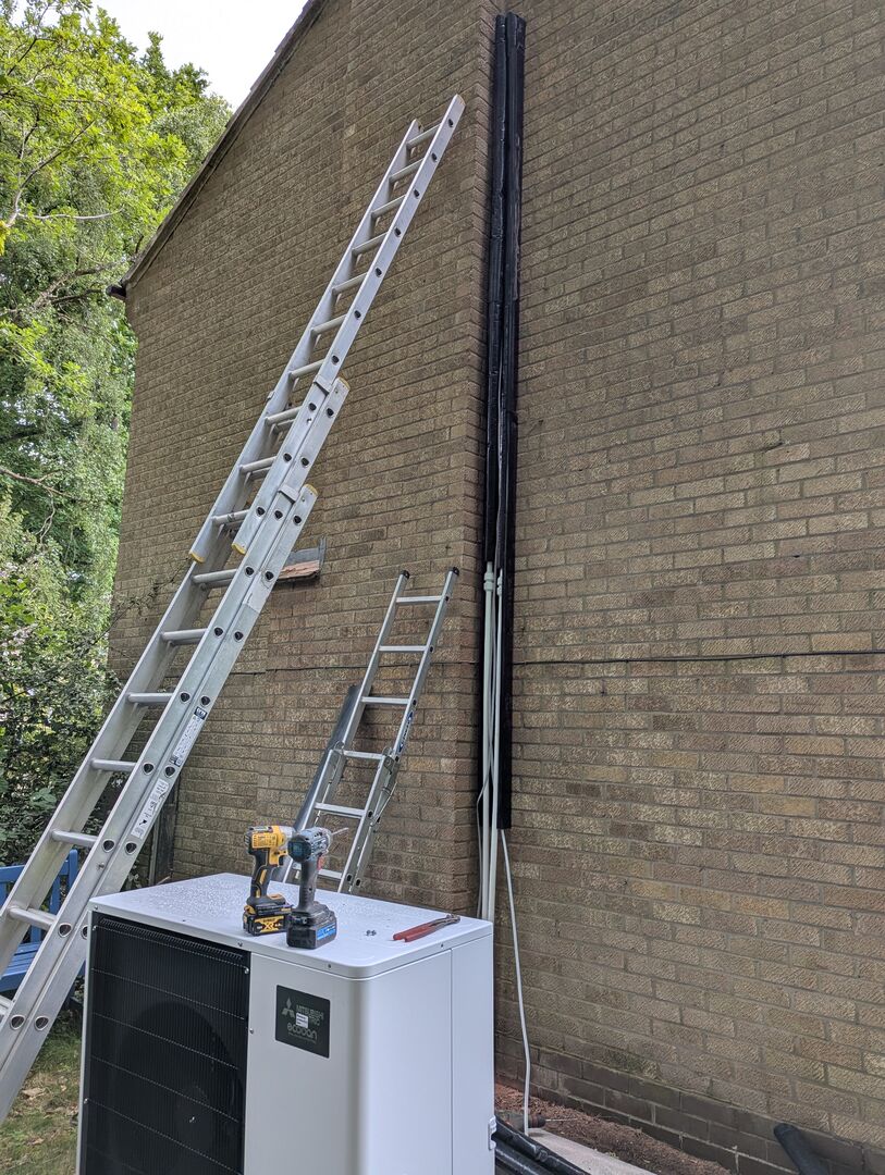

The outdoor installation looks neat, to my untrained eye, and the cylinder cupboard looks to have been done with thought - it's less of a jungle of copper wires than I've seen in some of the YouTube footage of installations (obviously, each job is unique so you can't compare directly, but it looks organised).  I had a quick peek in the loft too, and we've lost some storage space as expected due to the pipework, but nothing that's too problematic, and it might encourage us not to fill it up with quite as much crap again in future.
We obviously won't know how effectively the heating is going to be until later in the year, and how efficiently the pump will perform, but I'm very content with what I've observed over the last couple of days for an installation that was one of our cheaper quotes from a local installer that isn't a well known name.  I took great interest in their Trustpilot feedback prior to selecting them (which was positive with one exception, which I attributed as an outlier).  I'll be adding my own positive review on there in a few days, once I've had more time to ensure there are no obvious performance issues, although I have no doubts that any snags would be addressed by the team.  One of them is already planning to return to top up the soakaway with more gravel once the initial deposit has settled.
I've added a few pictures.  The cylinder cupboard is difficult to capture as there's limited space to take the photo from.  I'm conscious that this might show up some imperfections/points of criticism to those with better understanding of these systems than me, but they're being posted from the perspective of a satisfied customer on first impressions.  The initial satisfaction is based on the amount of work and care put into the job by the installation team, and the fact that they achieved the 2-day timescale which I was sceptical would be feasible.  Time will tell how the system is to live with, and whether any issues arise, but for now I have to say that the installation experience exceeded my expectations.

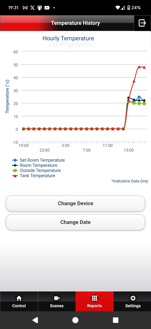

First update as a heat pump user:

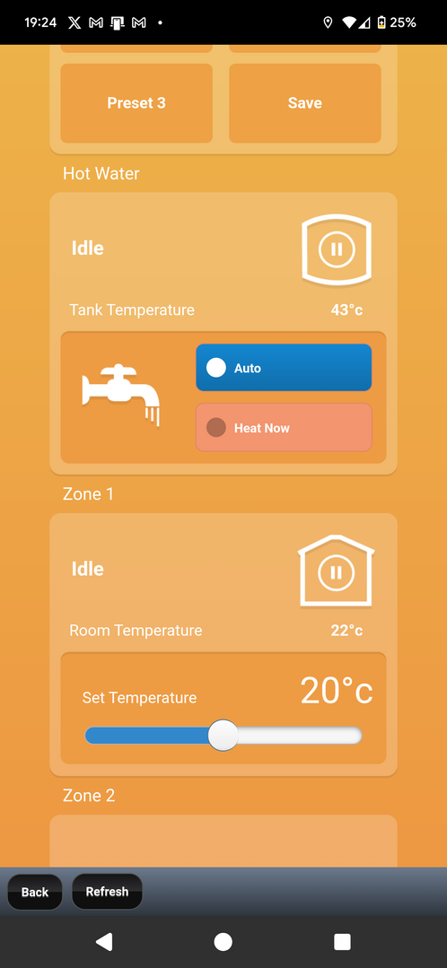

I gave myself a few hours playing with the MelCloud app on the evening of install, and on the morning the following day, primarily to see how intuitive it was to use and set up.  In fairness, I'm much more clued in (thanks to this forum) than a typical user would be, which is useful for me to apply a bit of perspective to the experience.
I got a brief handover of the system from the electrician after we had set up access to MelCloud, but this was very much directed towards how to set the temperature for heating and hot water, so very much aimed towards someone used to setting the system for a gas boiler.  I can understand why this was the case, as it probably accounts for the majority of heat pump users that he encounters, but it does give the impression that many of the users out there might still be using their systems inefficiently, as they'll be reliant on their own knowledge to understand the 'low and slow' concept.  The users of this forum are likely the top 1%, or something like that, in terms of understanding the technology, so it's easy to assume that this is general knowledge elsewhere.  The handover briefing was a reminder that this isn't the case.
In terms of MelCloud itself, it was fine in terms of basic schedule setting, and the limited amount of reports available within the app will suit most people, but I'd love to be able to interrogate them more.  The energy used/generated info is a little underwhelming, and it's reported as separate tables, so there's nowhere within the app that will give you a COP number, albeit there's the info needed to calculate one.
The system ran a legionella cycle on the first night, so the experience of hot water for the morning showers was somewhat distorted, as the water will have been hotter than typically set to achieve.  My wife, first to shower that day at 6:15am and who, compared to me, seems to like showering in scolding water, said she had to set the (anticlockwise) dial to 7 o'clock, rather than the 5 o'clock position that she usually did, and the water was still hot then.  Consequently, we warned the kids to expect hotter than usual water when they used showers and hot taps to begin with.
I've subsequently found the way to switch the legionella cycle on/off, but with hindsight it seems logical that the system would run one at first installation, so I have no issues with this.

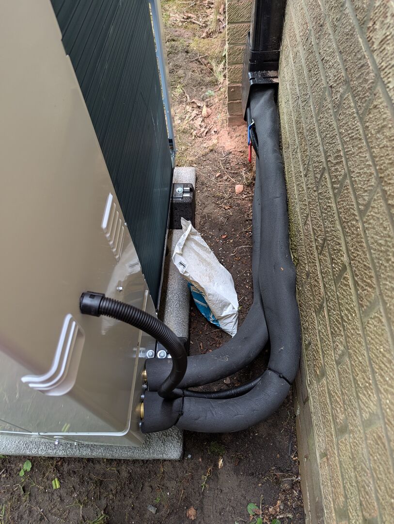

Congratulations on having your system up and running.
I just wanted to check with you the above image, as I'm not sure if that is the final installed image, or during the installation process, but the installation of insulation does not look ideal. Firstly, there is a small gap between the insulation and the heat pump, where the pipes are exposed. This should be sealed.
Ideally cable ties should not be used to secure insulation. The insulation should be bonded and sealed so that there is no way water can penetrate and leach heat away from the copper pipes. The rest of the insulation looks to be loosely fitted and it is not possible to see if it is sealed and water tight.
The plastic trunking running vertically down the wall is good as it should shield that section of pipework from the weather/rain, but the pipes within should still be well insulated.

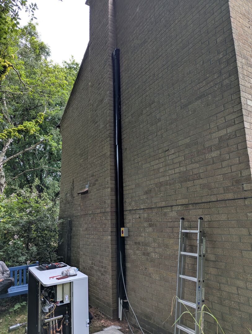

@old_scientist It's not the clearest photo, so I will have to look again when I'm home.
In terms of the pipework in the ducting, I know that this was insulated as it's something I checked on (out of interest, rather than any suspicion) during the installation.  I took pictures, when feasible without disturbing any of the workmen, and there's a couple showing the part-completed installation with insulation being added.
