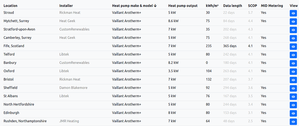

Our 7kW Vaillant is also performing better than expected in that October gave us an average COP of 5.8 and extrapolating from spot calculations would imply a SCOP of 4.5 instead of the 3.9 the installer predicted. We are currently using a coefficient of 0.55 when it was handed over with 0.6. So somewhat above efficiency prediction but not a lot.
On https://community.openenergymonitor.org/t/vaillant-inbuilt-monitoring-vs-mid-meters/24230 the conclusion seemed to be temperature monitoring (from which Vaillant calculate their COP) can have some measurement inaccuracy. So I’m very pleased with the values we see but not trusting them until we have enough data to completely compare with the heat generated (again inaccurate because of assumptions) over a season using gas.
If your style of radiators work then great! We had several of ours changed rounding the sizes up rather than down so we can run cooler, and hopefully more efficiently.
Its very mild so far this year so extrapolating is bound to be inaccurate.
