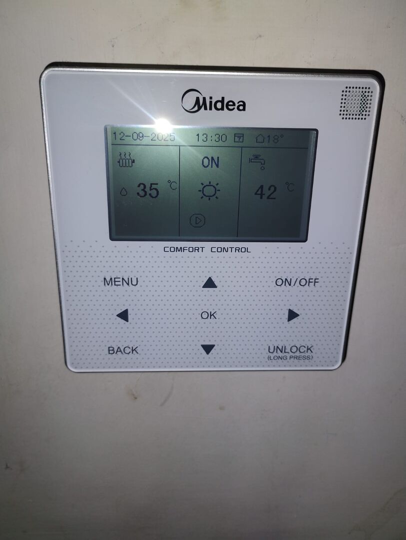

Posted by: @pash44pumpI have set up daily schedule for 13.00-14.00 when I usually have PV power and OAT is higher on average. My controller shows the 7 day timer schedule as a calendar icon. The DHW though is showing off - I'm assuming that it stays off and only comes on at scheduled times (which is why I'd have to do a manual boost if needed outside scheduled hours). Have I understood all this correctly?
Mostly, I think, but with some caveats.
I set the TIMER option (left most tab) on the Schedule Menu, not the WEEKLY SCHEDULE, just checking you have done the same?
In the image of the wired controller, the space heating is on (sun symbol in centre panel with ON, plus squiggles above rad symbol on the left, circulating pump is on (bottom of mid panel) but compressor has yet to start, when it does the petrol pump (hullo???) symbol will appear in the bottom of the left panel. This appearance is what I would expect to see a minute or so after turning the space heating on, either from 'all off', or switching from DHW heating to space heating, or alternatively during a cycle, ie the actual LWT is either at or a bit above the set LWT, so compressor is off. That may be the most likely explanation, given the OAT of 18°.
However, I also note the time shows 1330 today but your DHW tank temp (right hand number) is 42° ie there hasn't been a DHW reheat at the time the photo was taken (unless maybe you have just had a bath!). I think this is because although 52-10 = 42, ie you should get a DHW reheat, as I mentioned before, the Midea controller makes up its own mind on the borderline, and today it decided it wasn't going to do one. The other possibility is you set the timer during the 1300-1400 period, and I've noticed when I do that, it does not have immediate effect, it only kicks in the following day, at 1300.
If you need to do a manual DHW reheat, I suggest do it as I said before, temporarily increase the DHW set (target) temp, manual turn on etc.
You may also find you can drop your normal set DHW temp a bit, 52° is on the hot (scalding) side plus of course needs a bit more energy to get there, plus even modern DHW tanks are not that well insulated, they still lose heat, albeit usually to the inside of the house. I have mine set to 50°, others I know have theirs set to the high 40s.

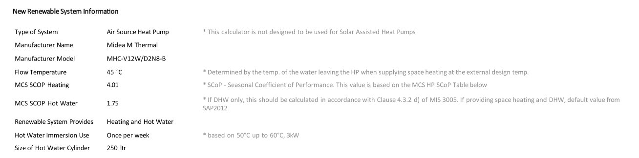

I have though been reading back through the forum now that I understand things better. One thing that strikes me is that the scope document states that the system should provide a COP of 4.01 at 45C flow temp with OAT at -1C. If I compare that to the Midea output table that @cathoderay supplied, that shows that at 45C flow temp and OAT of 0C the norm output shows at 9428 at a COP of 3.0. Where the hell does a COP of 4.01 come from and should they be held to that?

Posted by: @pash44pumpOne thing that strikes me is that the scope document states that the system should provide a COP of 4.01 at 45C flow temp with OAT at -1C. If I compare that to the Midea output table that @cathoderay supplied, that shows that at 45C flow temp and OAT of 0C the norm output shows at 9428 at a COP of 3.0. Where the hell does a COP of 4.01 come from and should they be held to that?
Do they mean scop? SCOP of 4 at 45 is reasonable.

@pash44pump - I think the COP of 4.01 comes from the 'scope' document, and if so it is a SCOP:
which they say comes from the 'MCS HP SCoP Table below' which looks more like part of their EasyMCS software output, though it may get its data from MCS. In any event, I suspect it is rather optimistic, to get a SCOP of 4.01 means having periods of very high COP values during milder weather, to offset the lower values when the OAT is colder.

@cathoderay I also note in that spec. that the DHW COP is well below 2; is it me or is this particularly low? I note that Adam Heat Geek often claims performances in excess of 3.5 or even higher - are they measuring the same requirements I wonder? Curious, Toodles.
Posted by: @toodlesI also note in that spec. that the DHW COP is well below 2; is it me or is this particularly low?
I noticed that too and thought the same thing, but then thought the DHW is only a small part of the overall energy use. The note alongside it suggests that it comes from the default value from SAP2012, which may be a clue (it is a default generic value). Typically my calculated energy out/energy in DHW COP values for my system are between 3 and 4 for the period in which the heating was running in DHW heating mode, occasionally a bit higher or a bit lower.
