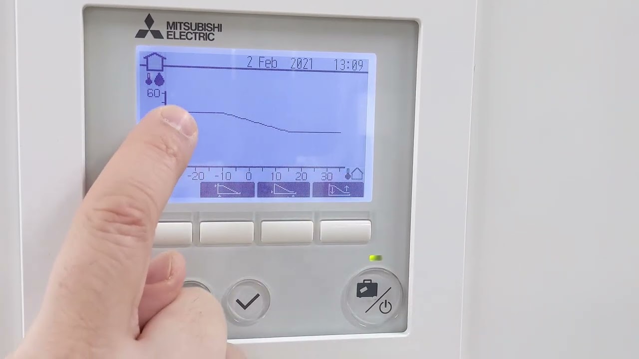

This video explains the different heating modes and how to select them
