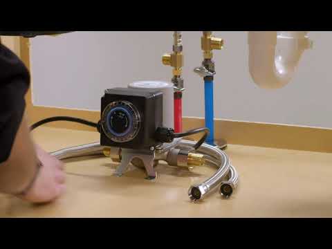

The type of purpose-made unit I have in mind is on many YouTube videos and is fitted with T's into the hot and cold supply under the sink/ basin. There are a number of manufacturers, but I haven't found one yet outside the US and Australia
I believe they divert the hot water feed to the cold feed locally, until a set temperature is reached. Some kind of timer would make sense because you wouldn't want this to be operating at all times. Your solution with PIR's is superior, but my plumbing would not facilitate a multiple application and I may be looking to fit one of these simple units just in the kitchen or perhaps also in the No1 bathroom.

I haven’t seen these before!!
It may be that they don’t comply with UK regulations.
In any case, you may save water but don’t you risk heating the cold water in the loft cistern?
My DHW tank (heated from an ASHP) is on to ground floor and water displaced from the hot water feed pipework, would be pushed along the cold water pipe back to the DHW tank. Might have to make sure there are no check valves in that line!!
