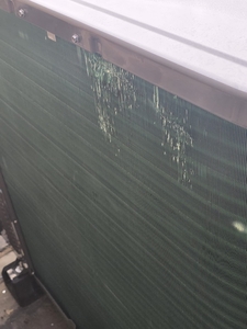

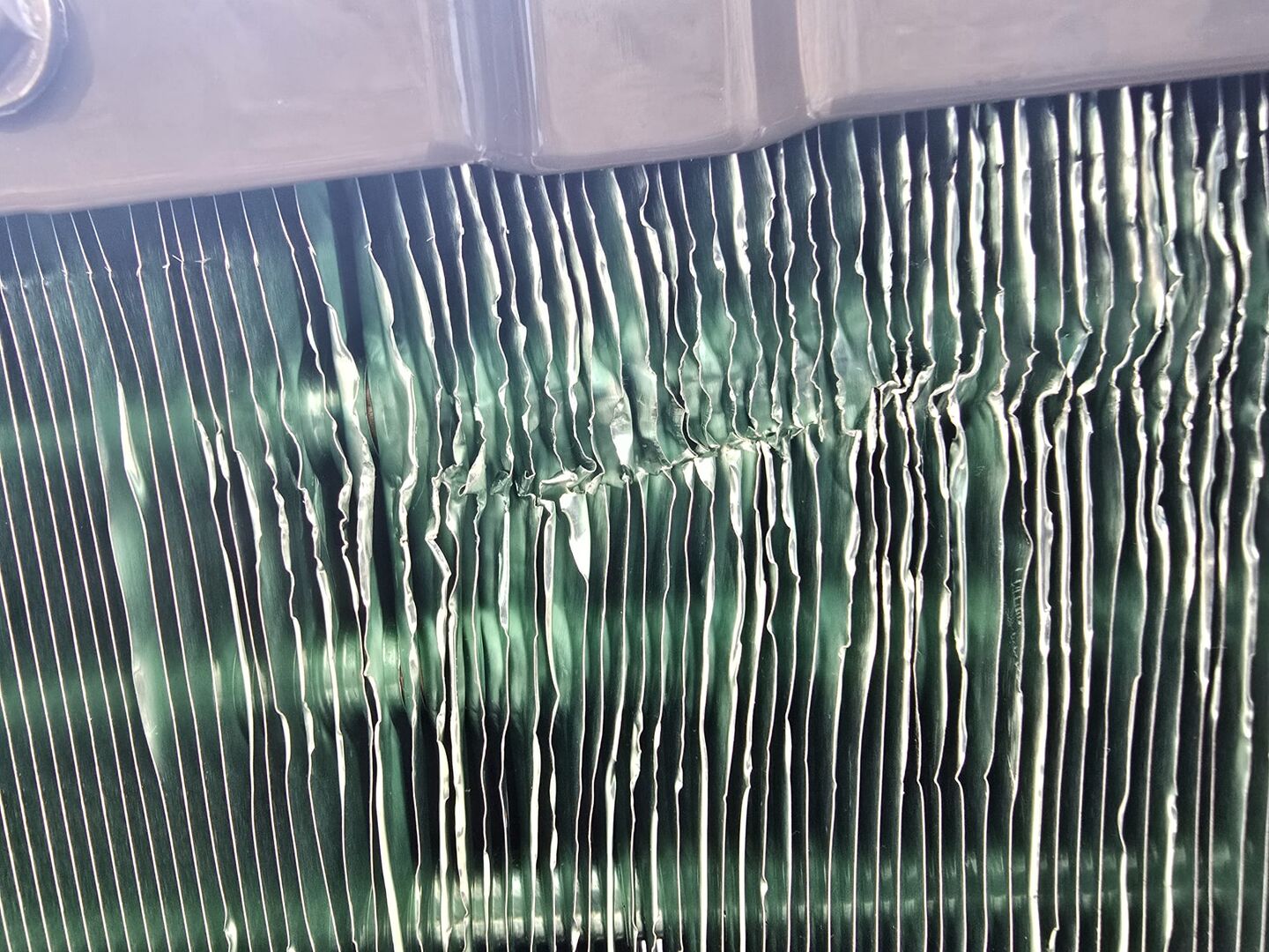

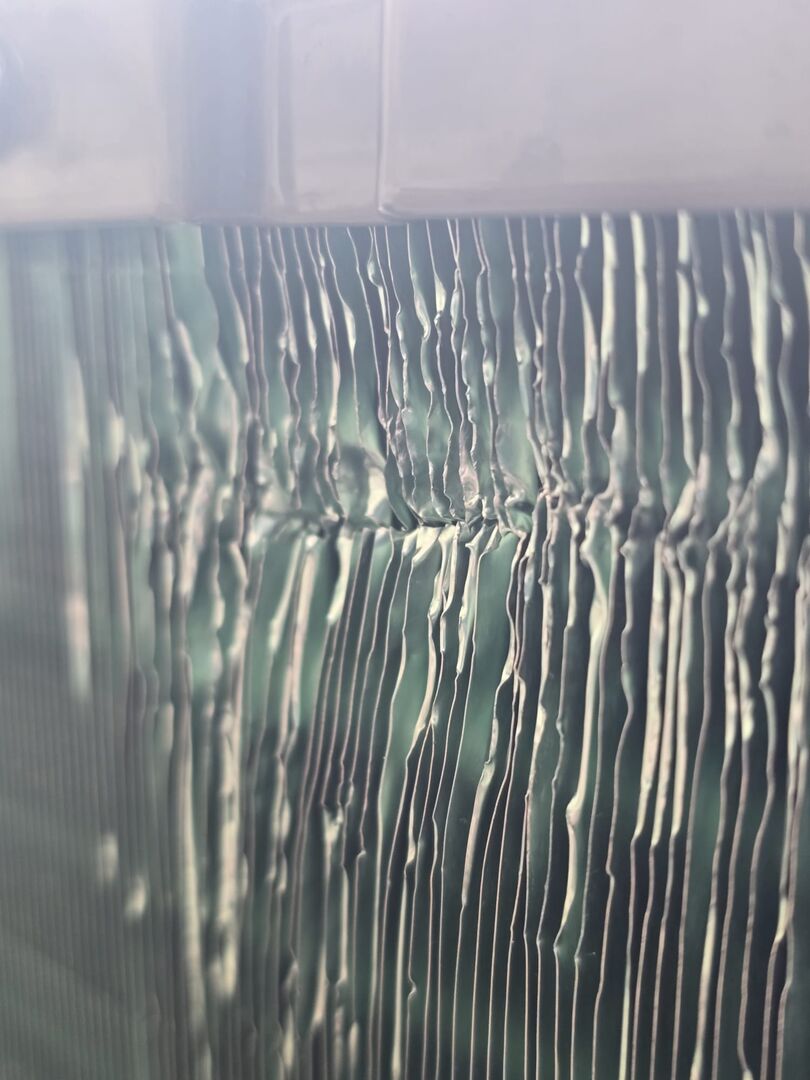

Heat pump install from a different firm, recommended by Octopus as an Octopus partner, has taken a week to date, with some really good work on the internals to replace some piping, remove the 15 year old oil boiler and cylinder. All the plumbing and electrical work looks great so far. However, when they came to move the heat pump they unboxed it prior to moving it. They balanced it on a 2 wheel sack trolley (not a pallet trolley like it was delivered on) to move it. It looks like they caught it somehow when moving it into my garden and there were a number (30+) of badly bent fins on a portion of the rear of the heat pump.
I discovered the damage, they didn't volunteer it. When I asked how they would rectify the issue they informed me that the supplier assured them it wouldn't cause any operational issues and to fix with a fin comb. I've included some pictures of the state of the unit after the fix. I don't know enough to understand if this will seriously affect performance, but after seeing the fix I've asked for a replacement unit. Looking for some guidance as to if that request is excessive, i.e. the unit would still operate fine with this damage?
Thanks,
I wouldn't personally say it's an excessive demand. It is significant even if it doesn't affect performance and I certainly wouldn't accept it either. It's a new unit that should be unmarked with no visible damage- that is what you have paid for, so I'd stick to your guns. Hopefully you have some form of final payment outstanding?

That’s more than the ‘typical’ amount of damage I’ve seen… installers always tell me it’s a tiny percentage loss in efficiency, but I don’t understand how these units get any fins damaged given how well they’re usually packaged.
I don’t think it’d be unreasonable for you to request compensation or a new unit…

They have already been dishonest by not telling you about the damage, so it is not surprising that they are telling you that it doesn't matter. You are justified in refusing to accept it. You have paid for a new unit, but this is damaged goods. You have no way of knowing how it was damaged, or whether there may also be some invisible damage. There is also a risk that the supplier might later refuse a claim under warranty, because it has been damaged.
