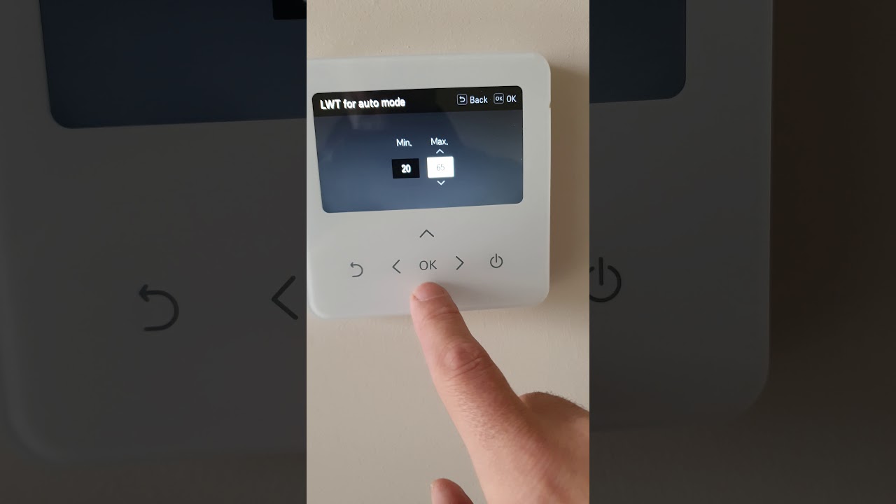

The unit in question is a HM161M.U33 Monoblock. The LG Engineer checked out the ASHP and declared that it was functioning correctly, but left it operating with a fixed water flow temperature of 50C. Ann and I have been working through the system identifying and correcting weaknesses and have greatly improved the operation and efficiency.
Although the manuals that we have both downloaded mention weather compensation, we have not yet found one that explains how to set the controller to perform this function. If anyone knows how to set up weather compensation on the above unit then please let us know.

@derek-m Is this any help

(@prjohn)
Posts: 125
@derek-m Sorry I should have said cut and paste and also remove the space before www. It was the only way I could post the link.

@prjohn
Thanks for the link to the video, it looks quite promising, though the guy needs to slow down a bit and explain what he is doing.
One of the problems with the LG manuals, is that they appear to use different descriptions, than some of the other manufacturers. It would also appear that some of the descriptions used for the adjustment parameters are rather ambiguous, which makes it difficult to decide which ones to use.

Would it be “Seasonal Auto Mode” in the installation menu? Seems to have upper and lower external temperatures and water heat flow temperatures, but also room air temperatures, so perhaps similar to auto adaptation.
Page 27
https://manualzz.com/doc/51473139/lg-hm051m.u43-installation-guide
Page 134, though for the HM051M.U43

Whilst watching the video that prjohn had located, which was quite useful, I noticed another video, which upon close inspection, I discovered, was one that I had already downloaded last week, which thanks to the pleasure of growing older I had forgotten all about. It is a longer more detailed explanation, which I think may have answered our questions.
At first, when I saw the graphs, I too thought that 'Seasonal Auto Mode' was where the adjustments should be made. Whilst adjusting the controller it was discovered that this functionality was not in the menu list. I have since discovered that it is the settings, at which the system would change operation from heating to cooling, if it were set up to have that capability. Because the system is not set up for both heating and cooling then 'Seasonal Auto Mode' is not made available in the list.
