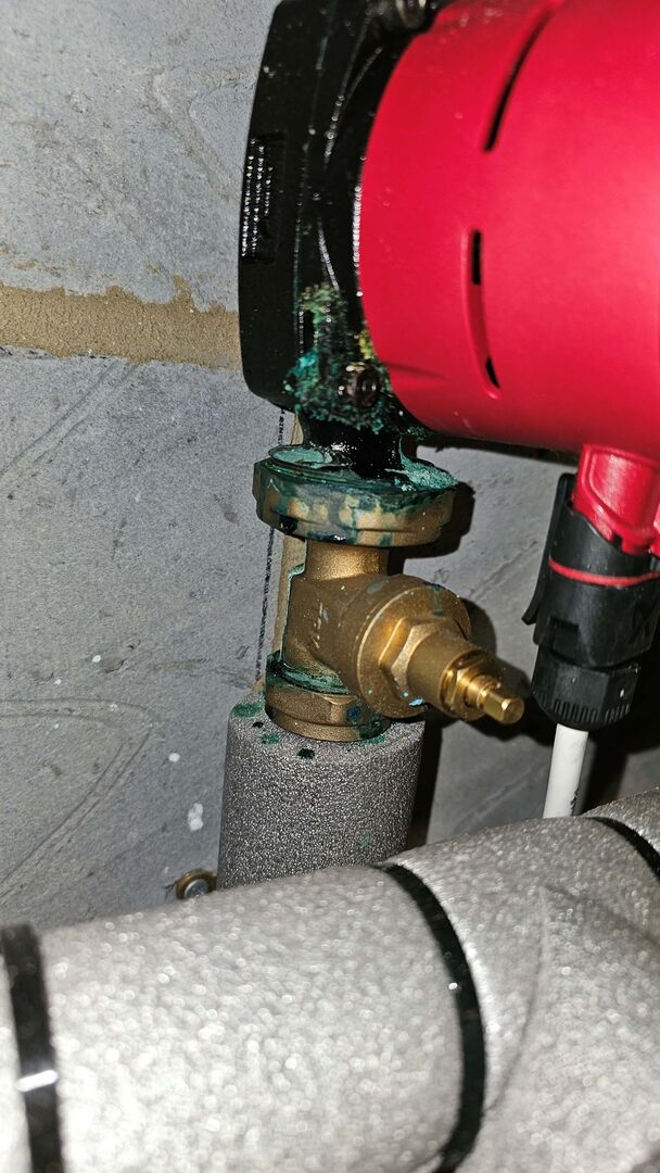

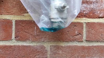

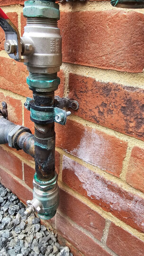

Hi, I know it's been a year since I put this thread on. I thought it would be nice to share my findings with losing pressure on a constant basis. I had two leaks which have most probably always been there since the installation now 3 years ago. I decided to strip back as much of the insulation cover in the whole system indoors and out to see if i had any leaks and there they were. The picture with the plastic bag is what the system was losing every 24 hours.
What concerns me is that I had two services from two different companies, both local and neither spotted them during the service.
