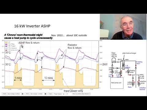

John Cantor covers this well in this YouTube session https://m.youtube.com/watch?v=0oszaqP0TI4
the critical aspect being is it at the limit of its turn down range and then short cycling (which is inefficient). If it isn’t inefficient then the being over-sized is fine, but often isn’t.
Then forcing the cycling to effectively a shorter time on period would be a good first tactic. This would work best with high thermal mass, eg. UFH or solid brick house with good insulation. Aligning the on time to cheap electric is an opportunity.
