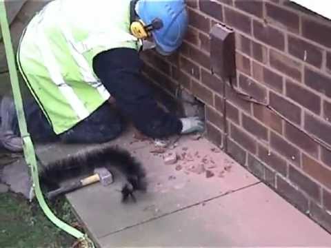

@transparent same company but I await a reply regarding this remedial work and the manager said that the cavity was filled last November why have I left it so long. Did he expect me to do a survey on the work, I only just noticed it because folk on here raised concerns regarding pipe work so I went under house and noticed it.
I was given a 7 year warranty on the heat pump because they are samsung registered geez you wouldn’t think so. I wonder what samsung thinks.

Posted by: @david999
I can't find that exclusion clause in the Consumer Rights Act!
That's only 5 months ago, anyway.
That doesn't sound an abnormally long interval before reporting a fault covered by guarantee.
Depending on the type of cavity insulation being used...
  • slots where the filler could potentially 'leak out' are first fitted with brush-strip. Air-vents are an obvious example
  • the manufacturer's certification process requires the installer to check for possible leaks before the documentation is signed off. Commonly, insulation beads inserted into a cavity under pressure can rise up past the wall-plate and into the soffit or attic space
