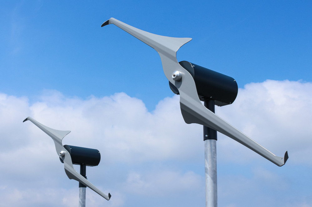

Ive been pondering the wisdom of buying a small roof mounted wind turbine to supplement my electricity production during the winter and comparing that against the wisdom of buying another 5 kWh module for my Huawei Lunar battery. Similar sort of price.
I then contemplated buying shares in a Ripple wind farm and the outcome surprised me.
Making a calculation of my average wind speed (4-5 m/s) my predicted output from the wind turbine was about 500 kWh per year. What that is actually worth to me is hard to work out but i settled for 15p/kWh (the octopus export rate)
I reasoned that I would only get a benefit from an extra battery for about 100 days in a year. Assuming that I filled it once at cheap rate and that saved me buying at peak rate, that might be worth 24p-7p=17p/kWh
Finally I bought an equivalent amout of shares in Ripple which provided 2400 kWh and saved £100 off my bill in the first year.
The one year savings between all three are similar but the big difference for me was longevity as shown in the table below:
Unless Ive misjudged something here, the winner looks clear. What do you guys and gals think?
NB there is also the point that the roof mounted wind turbine would need planning as I have a heat pump.

I was really interested in a wind turbine, but once I calculated the outputs, was way off being convinced. So 500kWh is give or take 1.5kWh a day. But to get that huge figure, you need zero disturbance of the wind, so ideally needs to be well away from houses and trees and also very high, otherwise the output does drop like a stone, turbulence kills effective output. Plus you will get inverter losses on any thing remaining.  Ditch that idea, would be my advise.

@editor I was looking at this https://www.myskywind.world/?gad_source=1&gbraid=0AAAAADlDXqXln-svRFFllLceCC5oYujF-&gclid=CjwKCAjwzIK1BhAuEiwAHQmU3i-IVX17xXneKTKdX4jXY-4a1nVzI9YZtkvTq1_pwESAhAyb3iFFkBoC4boQAvD_BwE

@bontwoody I've seen these before and wasn't sure what to make of them. As you've said, there's a lot to consider. However, we get pretty windy in autumn and winter, so they would generate some power to offset electricity consumption.
I think it was Derek who posted this turbine a few years ago. There's still no update from him, but it's a cool design with no moving parts.

@editor @johnmo The link says it’s still not in production yet.I wonder how efficient that type of design is compared to an open blade. I’ve also seen a type that sit on the roof ridge, will a cylindrical blade.

Looked at the manual, and any turbulence seems to kill output significantly and could reduce life of the unit by up to 80%. Pricing also seems significantly higher than you have quoted, by the time you made it had made mounts or pole, imported in to the UK, you would nearer £3500 to £4000

@johnmo @toodles I was using the summer offer price but hadnt accounted for roof mounts. So really with planning, low production, maintenance and mounts its really not in the picture. The Ripple looks like a safer bet than the battery, but both will be hit by reducing electricity prices.
