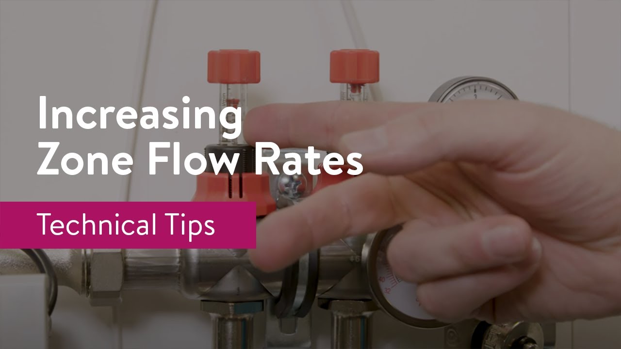

Posted by: @newhouse87
@transparent i think there is a red ring around each flow gauge that maybe i need to turn, they seem stiff however.
Get the manufacturer's name and model, then download the manual which should explain how to make adjustments. As I stated in my previous post, don't start adjusting flow rates until you have your heat pump operating continuously in WC mode.
Posts: 3503
Your energy: 41 kWh
It's not common to have any manual adjustment on an UFH manifold like that.
Don't start unscrewing red rings unless you are completely certain of what they're for!

@transparent
seems easy. Might lower it to 1.5. Bathroom right beside manifold so no way should it have same flow as loops farther down the house.
