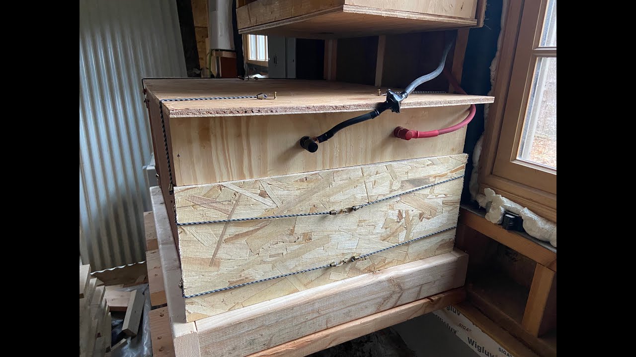

@bighorse I don't have that experience personally, mine are inside the house. That said I've seen a number of videos on the topic, below is a good DIY example. Personally I don't think its actually too difficult. The batteries will warm up themselves as they charge/discharge. Also if you can add the inverter into the box that'll chuck out loads of heat. I think a few bits of ply and some celotex will probably be totally fine for your needs. What is the make of the batteries/how large are they?
