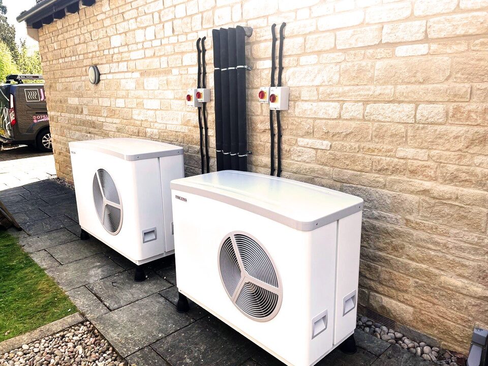

Whilst you cannot “cover” an air source unit you can screen them if you do so in line with the manufacturer’s minimum clearance requirements, which are provided in the installation manual. Typically, this is only around 300mm to the rear of the unit, so a common approach to reduce visual impact is to site the unit against a back wall of a property so it cannot be seen from windows.
Screening to the front and sides of the unit is possible, but again consideration must be given to free movement of air and minimum clearances.

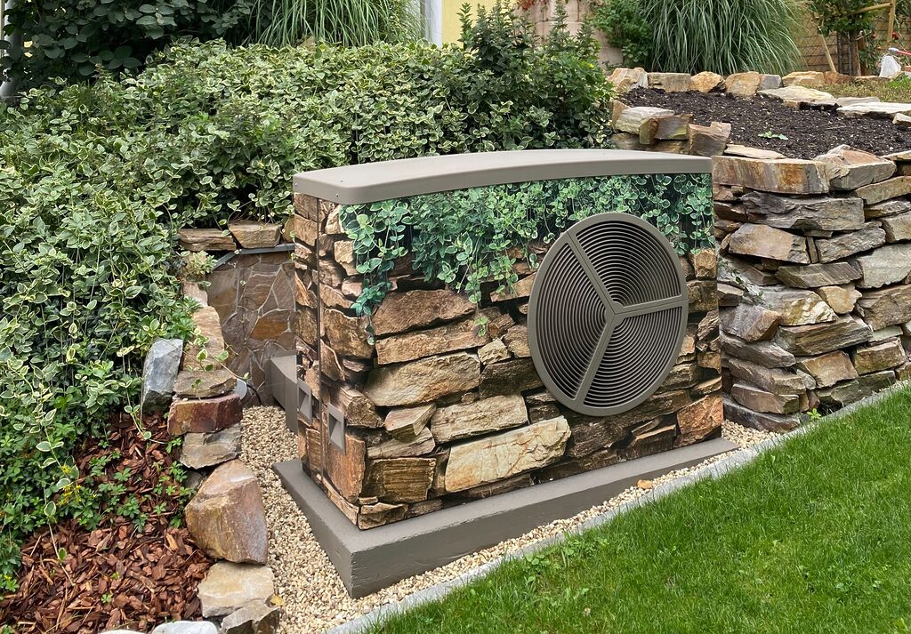

Another option to consider is camouflaging the unit with a custom spray paint or vinyl wrap. You should be aware that these may affect the warranty on your casing, but homeowners do often seem to consider that an acceptable risk.
