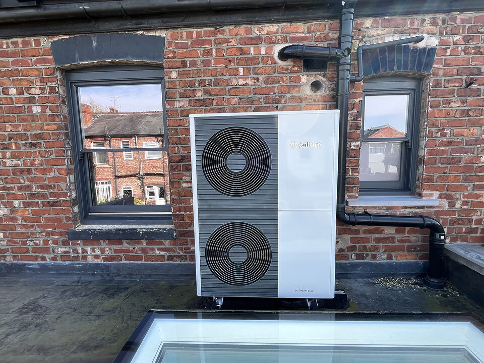

We are an unremarkable couple in our 60s, living in a 1900 three-bedroom terraced house in South Manchester. In 2022, after receiving a small inheritance from our parents, we decided to take the plunge and invest in a new central heating system to replace our temperamental 30-year-old boiler.
After much research and deliberation, we decided to ‘do the right thing’ environmentally and invest in an air source heat pump. The environmental credentials were appealing (roughly four units of electricity generated for every unit consumed), as was the government’s support in the form of a BUS (Boiler Upgrade Scheme) grant which, at the time, was £5,000. We would also be able to get rid of the gas supply completely and save additional costs by not having to pay the monthly gas standing charge.
We didn’t know of anyone else who had installed an ASHP, so we were in unfamiliar territory and learning one step at a time. There were so many acronyms to come to terms with (EPC, MCS, NAPIT, BTU values, BUS grants, CWI…).
It was complicated and confusing, and we felt quite overwhelmed and lacking in confidence. It would have been so helpful to have had some independent, easy-to-understand overview of the process… a metaphorical ‘holding of our hand’ through it all. We didn’t know where to look. Advice seemed patchy and far too technical for us newbies to understand. We were both working full time, still supporting adult children, having building work done and had very little spare time to deep dive into the world of heat pumps. But we took it one step at a time, researched as much as we could, and kept asking lots of questions.
The first step was to find an ASHP installer. We knew from online research that it was important for the installer to be MCS registered. We contacted ten installers based in and around Manchester, all of whom were MCS registered. After asking some basic questions as part of the initial enquiry, we shortlisted these down to five. We invited them to come and look at our property with a view to providing advice, a quote and a recommendation for which model of ASHP they thought would best suit our home. From the quotations received, we chose RA Renewable Solutions. We discussed the pros and cons of different ASHP models and settled on the 11kW Vaillant aroTherm. They were also happy to install underfloor heating in the kitchen as part of the installation, which some installers were not willing to do.
To qualify for a BUS grant, we had to commission an EPC (Energy Performance Certificate) assessment and implement any recommendations, particularly in terms of insulation. The assessment recommended cavity wall insulation (CWI). However, because of the age of the house (1900), our walls only had finger cavities which were too narrow to accommodate regular insulation. This all had to be proved and documented.
Firstly, we had to commission a chartered surveyor to inspect our walls. He asked us to commission a CWI installer to inspect the walls with a borescope and send him the photos, which we did. Three reports later (and a rapidly depleting budget), we were finally able to complete a ‘Cavity Wall Insulation Exemption Form’. Instead of CWI, we committed to removing the existing plaster on the two external walls (front and back) and replacing it with new thermally insulated plasterboard, which would have the same effect. With this in place, we were finally eligible for the Government’s BUS grant.
The next step was to buy radiators so that the builders knew where to put the pipe centres when installing the plumbing first fix. The ASHP installer commissioned an assessment of the BTU values required for each room. This came to us in the form of a rather blurry, difficult-to-read WhatsApp screenshot, rather than the detailed report we were expecting. However, we took it along to a radiator retailer and asked them to interpret the values for us so that we could properly size the radiators. Radiators were ordered and pipe centres marked on the plans.
An ASHP system needs a large water tank. We had originally specified a Vaillant uniTower hot water cylinder. However, after discussions on site, the installer suggested we change this to a horizontal hot water cylinder, which would fit under the eaves in the loft and be a better use of space. We emailed the installer to ask if the new cylinder (Joule) was compatible with a Vaillant ASHP system and whether it had a warranty comparable to the Vaillant uniTower. We received a reply confirming that the Joule cylinder was compatible with our ASHP system and had a 25-year guarantee.
There were some delays to the building work. Some were the fault of the builder (subcontracted suppliers were not organised in a timely manner). Others were caused by unforeseen structural issues. After removing the old plaster to replace it with thermally insulated plasterboard, it was discovered that the front elevation of the house was structurally unsound and had to be rebuilt. We provided the ASHP installers with the builders’ contact details and vice versa so they could coordinate timescales. We asked the installers whether the delays would affect the BUS grant (given the three-month expiry period) and were assured that it would not.
Once the installation was completed and we had paid in full, we received an MCS certificate and an IWA Insurance Certificate by email. The installers received a £7,500 BUS grant as part of the final payment. We did not receive a formal ‘handover pack’ explaining how to use and maintain the system, which we later learned should have been provided. Instead, the installer verbally explained the controls. There was no independent verification that the system met required standards, and as homeowners, we were not qualified to assess whether everything had been done correctly.
Four months after completion, we experienced a serious water leak from the area of the water cylinder. The leak was severe; water came through the ceiling and ran down the walls below. We tried contacting the installers via WhatsApp and email but received no response.
Following guidance from Ofgem and MCS, we contacted the MCS helpdesk. They advised us to write to the installer by letter and allow 14 days for a response. NAPIT provided the same advice. We were also warned that using another installer could invalidate warranties and insurance.
This advice was impractical. We had to turn off the water to prevent further damage and could not realistically live without heating or hot water for two weeks. We eventually found another engineer who agreed to help as an emergency. He fixed the immediate issue (a failed automatic air vent) and identified multiple problems with the installation. We commissioned a report detailing faults, non-conformities and recommendations.
The scale of the issues was a shock. We followed the formal complaints process, but the installer denied any problems. One key issue was the hot water cylinder, which was not a high-gain model suitable for a heat pump system. The installer claimed it was. We contacted the manufacturer directly, who confirmed it was not suitable.
We then commissioned a second independent report from a Vaillant engineer, which corroborated the findings and identified further issues, including electrical faults.
Shortly afterwards, we discovered the installer had ceased trading. We submitted a claim to the insurance provider (IWA), which was rejected because we had not contacted them within 30 days of the issue arising, despite following official guidance at the time.
After escalating to the Financial Ombudsman, we initially won our case, but the insurer rejected the claim again under a different clause. Ultimately, only two minor issues were accepted for coverage. The majority were deemed ‘upgrades’ rather than defects.
After months of further reports, evidence gathering and correspondence, we were left with an expensive, poorly installed system and no meaningful recourse.

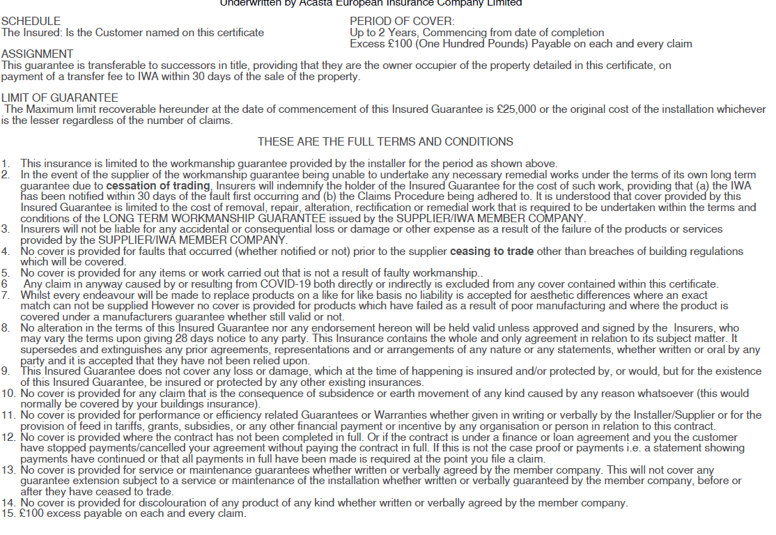

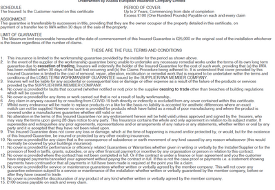

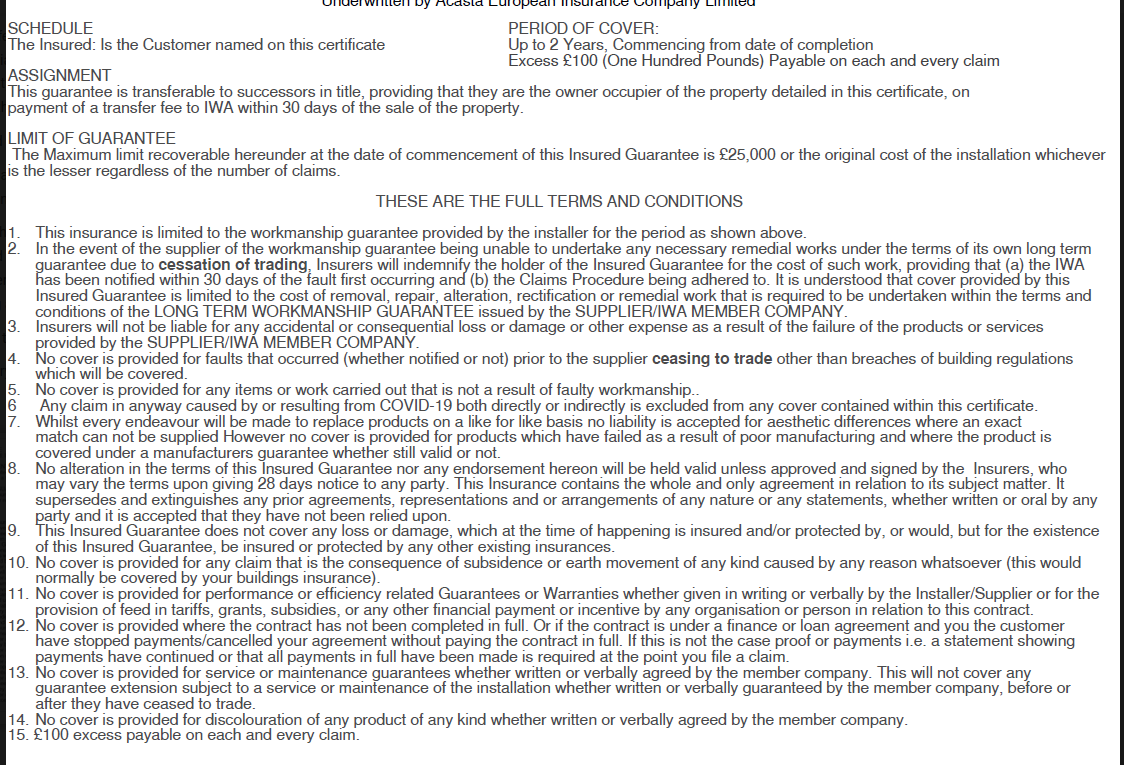

I have just dug out my own guarantee (which is by IWA) and read the conditions, which I reproduce below.
Its pretty limited.  Its cover applies only if the supplier has ceased to trade.  Faults must be notified within 30 days otherwise they are not covered.  Faults which occurred before the supplier ceased to trade are not covered, whether or not they were notified.
The effect of this in practice is to exclude pretty much any poor workmanship (because the fault occurred before the supplier ceased to trade).  Essentially, as I read it, it would cover only failed parts occurring after cessation of trading, which would probably anyway be covered by manufacturers warranty.  So it’s only obvious value is cover for fitting the parts.  Also crucially it won’t cover anything if the fault occurs before a supplier ceases to trade, they fillibuster, and then cease.  This is another hole in something that is already a collander masquerading as a saucepan.
I would personally rate this insurance as near worthless.
I must admit the very strict limits of cover, some of which I can understand but some of which I can’t, have come as a surprise to me.  Its not positioned this way by the industry imho.  The old saying ‘insurers never take risks’ certainly applies here!
Nevertheless, shocking though it may seem, I can see no way that this can be reinterpreted to cover poor workmanship occurring before the supplier ceased to trade.  @Ian it might be worth your while reviewing your list in case there are further elements you could dispute.  I’m presuming the installer went into administration in which case you may have a claim on that, but you are not a preferential creditor so in practice the probability of getting anything is small.
I know this is not what you want to hear but it’s probsbly better to be realistic about the prospects, as @Mars says above.
I would personally rate this insurance as worthless, in the sense that I would not pay even a penny for it.

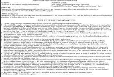

We just received an initial guestimate from EDF for a BUS heatpump install. It included an IWA leaflet…
This is an extract of what it says for deposit protection:
At the time of paying a deposit you should be issued with a Deposit Protection certificate from IWA. This document will protect your deposit, prior to the commencement of the contract for up to 25% of the contract value, subject to the terms and conditions on the certificate
Also, for the IWA Guarantee Insurance:
Your contract will be insured for a period of up to ten years and is underwritten by FCA authorised Insurers,subject to the terms and conditions on the Certificate.
Then, under Warning:
In the event of an insurance claim refer to the Certificate for the procedure. If you have not been issued with a policy you do not have insurance cover.
And EDF did not include the terms and conditions for neither the IWA Deposit protection nor the Guarantee when they send the IWA leaflet…
Interesting, my protection was only for 2 years and, as I post above, essentially worthless.
I didn’t even get the terms of the insurance when I contracted, I only got them after completion.  Given the wording of the insurance itself (if yours is similar to mine) this is arguably mis-selling by the installer (who has probably never read the terms himself).

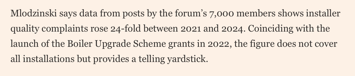

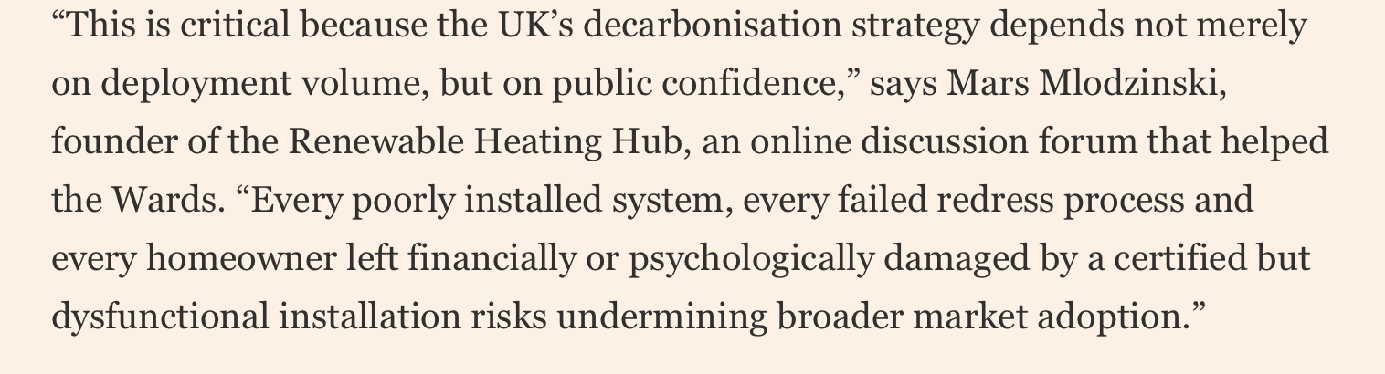

Most of you will have seen Sarah and Ian Ward’s thread and their experience of a botched installation in south Manchester, an incompatible cylinder, a collapsed installer and an IWA insurance policy that turned out to be near-worthless when they needed it most. We published their story on the site and I’ve been working with them in the background since to try to get some traction.
Today that work landed. The Financial Times published a full reported piece on what happens when heat pump installations go wrong, and Sarah and Ian are at the centre of it. Renewable Heating Hub and our forum data featured centrally in the piece too. If you haven’t read it, it’s worth your time: https://www.ft.com/content/83d3342b-55dd-4414-8ccc-e7c25423550e
Here are some RHH-related snippets from the piece.
Mars FT
Mars FT3
Mars FT2
Now, to the MCS bit in the article, because this is where it gets interesting.
Ian Rippin, CEO of MCS, made two commitments in the piece. First, that MCS will from now on handle all complaints an installer hasn’t addressed. Second, that all 5,000 UK heat pump installers will be vetted before admission to a new scheme by March 2027, focused on quality work rather than paperwork.
The driving test analogy used in the piece sums up the structural problem as well as I’ve ever heard it put: when the enforcers who run the driving test depend on subscription fees paid by the very installers they’re supposed to be policing, you can fail the test and still be waved through. That’s not a bug in the MCS model… it’s a feature (possibly intentional) of how it was built. The certification bodies are private companies with a commercial relationship with the installers they certify. The incentives are not aligned with the consumer… I’d argue they are polar opposites.
So are the commitments welcome? Yes. Are they sufficient? I really don’t know. And do I have confidence in MCS’s ability to execute? Based on track record, definitely not.
This is an organisation that has been aware of the complaints problem for years. Our own forum data, which I’ve shared with MCS directly, showed installer quality complaint mentions growing 24-fold between 2021 and 2024. Not 24%. 24-fold!
The certification concerns in our data grew 259% over the same period. MCS has known the direction of travel for a long time and the response has been slow. The IBG insurance framework was also structurally flawed from the start.
@JamesPa pulled out his own IWA policy in this thread and concluded it was near-worthless. MCS-approved insurance that is near-worthless is not a minor administrative oversight. It’s a shocking failure of consumer protection!

Many of the estimates we received mention IWA and RECC. I try to not read much into it. As @JamesPa says, an installer is not expected to be able to evaluate these products in detail.
The method used to sell this insurance, where someone agrees to it with only a title of a document (the document only being made available when requested) gives it away a bit.
But if consumers are to consume, they cannot be mentally testing and investigating every possibility to identify what seems to me a plain and simple an insurance scam. Products like this are simply abusing the system of Financial Regulation that the vast majority of industry parties stick to. These are parasitical relationships, the effect being very similar to misuse of a brand.
@Batpred spot on.
When a consumer agrees to an insurance product by accepting a title rather than reading terms that are only available on request, that is not informed consent… it’s a process designed to generate a signature rather than genuine understanding and the FCA’s own rules on fair presentation of insurance products exist precisely to prevent this. Whether those rules are being applied with any rigour to MCS-attached warranty products is a question that has not, to my knowledge, been asked publicly or answered.
Your broader point about the limits of consumer due diligence is one that the financial services industry has been resistant to accepting for decades. The theoretical position is that consumers should read everything before signing. The practical reality is that nobody does, nobody can, and the system is structured in a way that exploits that gap rather than closing it. A product that relies on the consumer not reading the exclusion clauses in order to sell is not a product that has been designed in good faith… and that’s precisely why the insurance industry is worth billions.
EtchedPixels
“The method used to sell this insurance, where someone agrees to it with only a title of a document (the document only being made available when requested) gives it away a bit. "
Fortunately insurance is covered by the consumers rights rules so misrepresentation, and unfair clauses are covered. Might even be an opportunity to sue the installer as well if the installer or their professional body had reason to believe the insurance policy was not actually of any use and so were either mis-selling it or negligent.
I’m not sure its a failure of consumer protection so much as a failure of people to know their rights and be willing to take on insurers all the time. Deny Delay Defend isn’t just a US healthcare scum thing, it’s the whole industry that relies on people not being willing to take every reasonable refused claim to arbitration or small claims.
The laws are there, the enforcement is as ever a joke because UK government wilfully defunded everything involved in regulatory oversight to the point that our rivers are full of turds, our shops full of unsafe goods, kids sand has asbestos in it and temu sells exploding ebikes with impunity. Trump was incompetent and abolished everything he hated so people noticed, our lot were just smarter and people didn’t notice.
