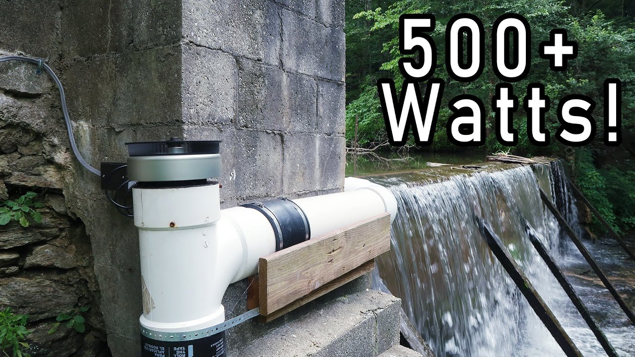

(@batalto)
Posts: 1092
@transparent these guys had a fun DIY crack at a low head turbine.
262m2 house in Hampshire
Posts: 3398
Yes, I agree with @batalto that it's possible to run a micro-hydro generator with a low-pressure head of water. But let's note that the author of that YouTube clip was getting pretty excited about the yield being as high as 500w, which speaks volumes before you even watch the video!
May I again draw attention to the Renewables First website which prints the following information:
From which I've taken the first two columns and plotted them:
HydroGen2
Personally, I would still think the 5kW output worthwhile striving for if I wanted to run a domestic heat-pump.
But if the available water-head isn't great, then I'd need to be more careful in choosing the optimal size of the delivery pipe. There have been some pretty good outcomes from DIY experiments using standard plastic waste pipe.
