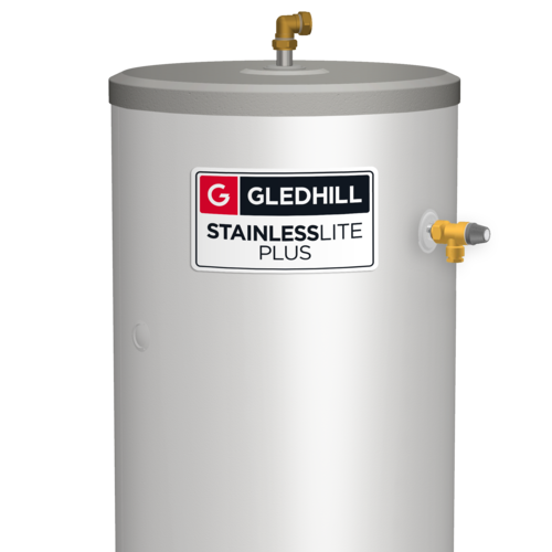

@cookie197 For your information you can get slimline versions of HP tanks. I am looking at one at present as it needs to fit in the space currently occupied by my solar tank which is 550mm in diameter. As an example: https://www.gledhill.net/products/unvented-cylinders/stainlesslite-slimline/
As mentioned our HP is a high temperature version and will produce DHW up to 55C on its own. The test for me was the Wife and her bath temperature ( 45C ) and I am still alive to tell the tale! So big green tick. I would not worry as the new HPs are quite capable of hot water production and can be programmed to simply maintain the hot water temperature by heating up only the amount you use (indirect version of a combi). I believe the insulation of new tanks is very low in losses, another reason I am upgrading in October as mine shows a distinct heat drop after a couple of hours due to its design.
