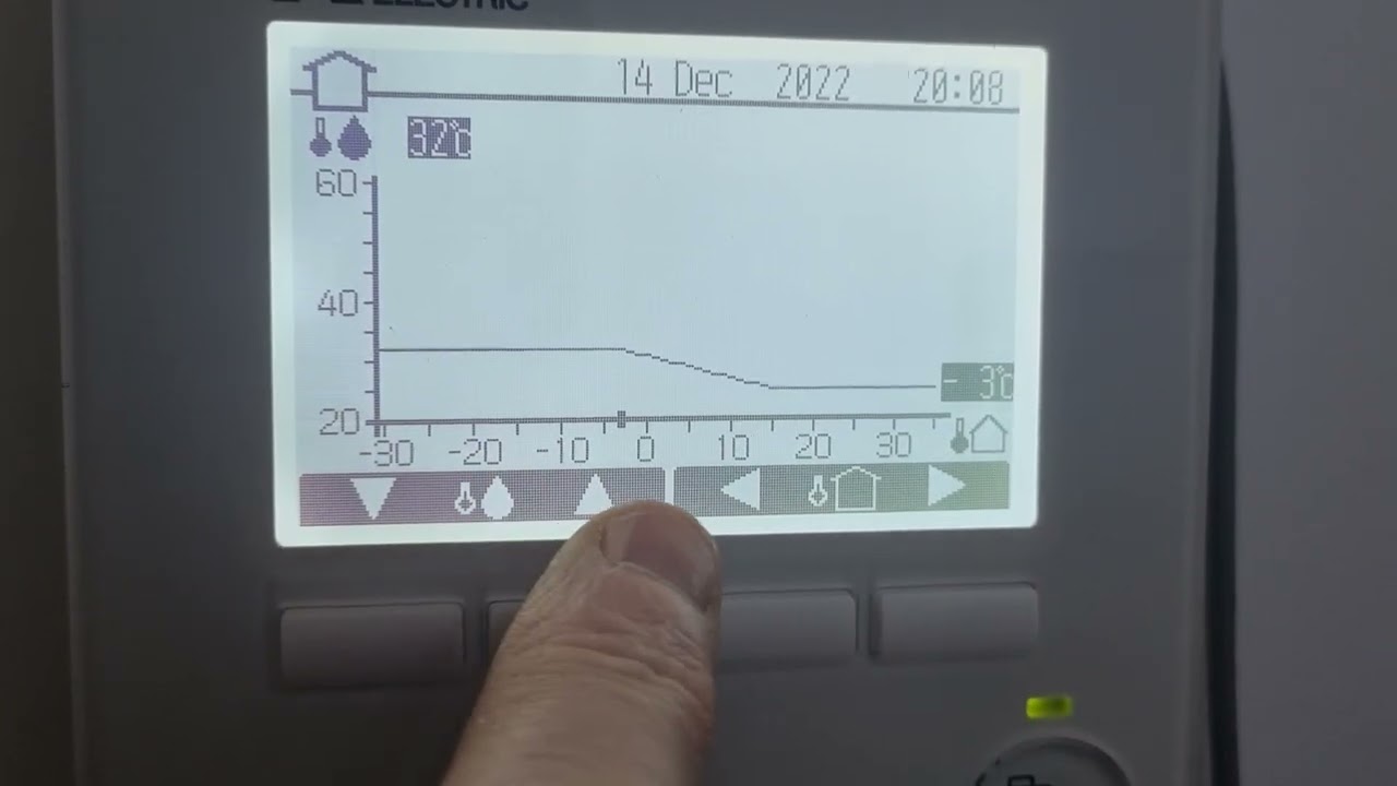

We know you are running in Weather Compensation mode from the image you posted of the controller on the other thread
Post an picture of your compensation curve, to get to it press the main menu button then go to heating, on right side of the screen you will see a magnifying glass press the button under that option and that shows the compensation curve you are running.
Will look something like this

upd2… and WC dropped to 32degree flow at -3 and 25 degree flow at +15. Let’s see how we go!

You adjust the end points of the sloped line.you presented earlier. This will be somewhere in the menu, probably the installer menu. I would reduce the flow temperature at the low end (oat -10 I think) a degree or max two degrees at a time, perhaps no more frequently than once every 12 hours. Once it gets close less frequently. You should probably set times controls to avoid the expensive cosy period only.

@carpenterstation your aren’t running auto adapt the curve symbol I circled means pure weather compensation.
Here is a video on how to adjust your curve, it’s the same process I showed you to access the curve just hold down the menu button to access the adjustment menu
