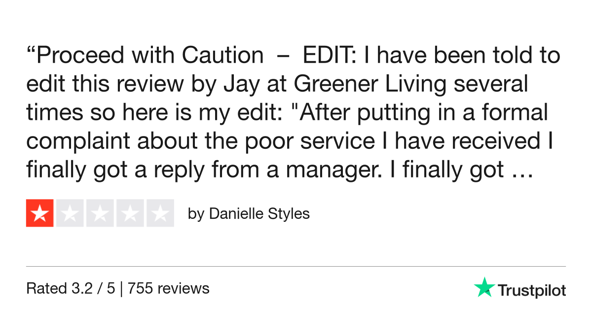

I have microbore piping downstairs and 15mm piping upstairs, not been told this is an issue/factor in anything, but having seen a review im further sceptical https://uk.trustpilot.com/reviews/6042273cf85d75064c3859ee

I'll conclude by recommending you get another quote (or two) – this is critical @aj_ok - we got five or six quotes before puling the trigger because it really does allow you to evaluate what's really needed specifically for your property.
Hi @aj_ok !
Have you ordered the work from Greener Living?
They are currently trying to convince us for an installation. I'm all in favour of it, just trying to do the due diligence about the company.
They've got quite good rating on Trustpilot with some terrible reviews, too.
