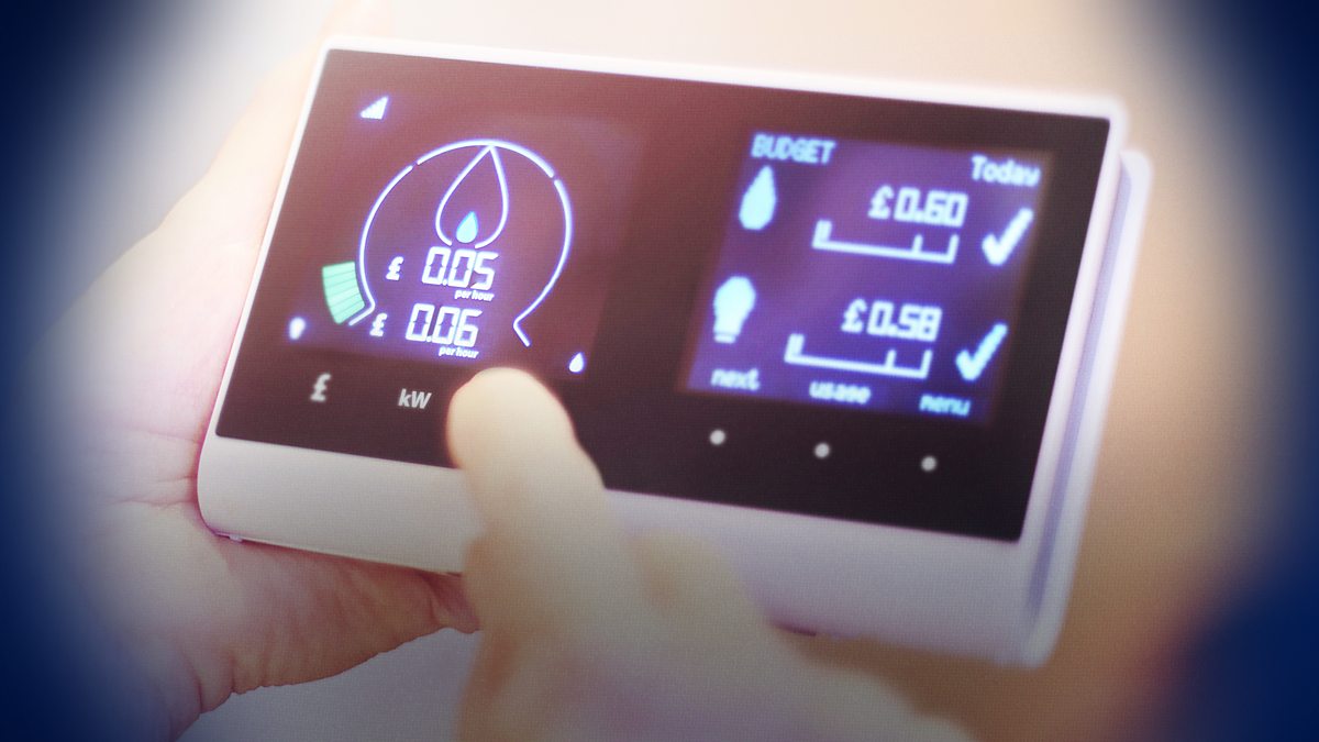

"Smart meters are supposed to make paying our energy bills easier and cheaper. "
That's a bold statement. As I recall, they were 'sold' on the promise that energy users would be able to keep a close watch on their energy use and spend by using the accompanying In Home Displays. The bills will only be easier to pay in the context of them being cheaper and that is only the case if the bill payers monitor the displays and change their behaviours. In reality, the poor installation and reliability of the In Home Displays have acted as a proxy for non-working smart meters. Even when they connect to the smart meter the displayed costs may be incorrect as a result of the tariff details being wrong. As a result, the In Home Displays are often not disconnected and misplaced; in many cases, during house moves. Was there ever a good reason for them needing to be registered with a smart meter by a technician? Smart Meters now have a bad reputation as a result of the SMETS1/SMETS2 fiasco, the inconsistent & unreliable communications methods and these In Home Display issues. Although customers have had to pick up the bill for smart meters through increased charges, the main benefactors have been the meter manufacturers and the energy retailers who now don't need to have the expenditure of meter readers.
