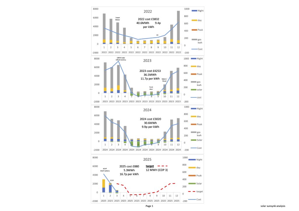

Energy Usage and Cost Analysis
Our investments in solar panels and air source heat pumps totalled around £30k, with a long payback period anticipated. However, these changes have allowed us to maintain energy costs close to 2022 levels, despite rising prices.
  • 2022:
    Cost: £3,758 | Usage: 39.7MWh | Average cost: 9.5p/kWh
    Heating was heavily used from November to April, with minimal usage from May to September.
  • 2023:
    Cost: £4,253 | Usage: 36.5MWh | Average cost: 11.7p/kWh
    The installation of solar panels and batteries reduced net usage from 10.7MWh to 7.5MWh. Time-of-use tariffs were exploited in Q4.
  • 2024:
    Cost: £3,020 | Usage: 30.6MWh | Average cost: 9.9p/kWh
    Batteries and solar panels helped absorb price inflation, with net electricity imports dropping to 1.5MWh.
  • 2025 (so far):
    Cost: £880 | Usage: 5.3MWh | Average cost: 16.7p/kWh
    Target: 12MWh (COP 3) at 12p/kWh. Energy usage in January and February has significantly reduced compared to previous years.
