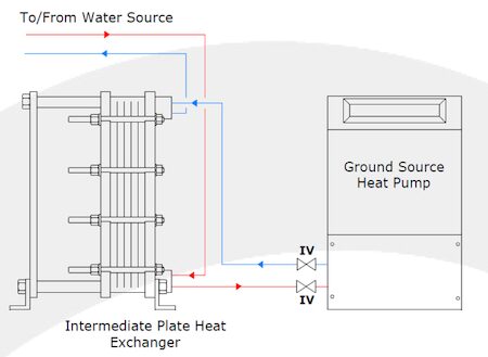

Then I read about an open-loop system using a plate heat exchanger as the interface. Having worked in an engineering career and having knowledge of heat exchangers, the design then started to materialise.
Open loop diagram

  • Design of river water chamber/sump to provide volume and clean water for the primary circulation pump
  • Abstraction regulations for the water course
  • Selecting a suitable pump for the river water duty – efficiency and quality
  • Location of the heat pump to minimise noise
  • Location of buffer vessel and all ancillary equipment
  • Location of DHW (domestic hot water) tank on first floor due to weight and structural requirements

Raw water pump35W variable speed submersible aquarium pump. 240V AC set to flow 18 l/min, @ 14W absorbed
Heat exchangerUKE 6 kW stainless steel unit with 17 plates

The heat exchanger is installed in the garage, with underground pipes connecting it to the river water pump and also the heat pump in the main house. The heat pump is quite noisy, and despite being advised that it would be suitable for installation in a utility room, we decided to locate it in what was originally designated as a cloakroom off the utility room to house the heat pump, manifolds and in fact all other plumbing and electrical services for the house. This was a good decision as there was no other space for the buffer vessel.

On the external side of the system, when the heat pump is running, it circulates a water and glycol solution through the secondary side of the heat exchanger. The secondary circuit incorporates a flow switch which detects flow from the heat pump and will start and stop the external river water pump on demand.

Being a GSHP, we do not have an external unit with a fan. Our compressor unit is installed indoors and receives a flow of Glycol solution in a closed loop to an external plate heat exchanger. The control is a simple cascade system whereby, the controller calls for the heat pump to increase the temperature in the underfloor circuit. The compressor and the glycol circulation pump starts, and a flow-switch on the glycol circuit switches on an external water pump which in basic terms pumps water from a stream into the primary side of the plate heat exchanger, from which it flows back to the stream under gravity.

Hi. Thanks for your comments. The heat exchanger is a stainless steel plate type, and although the materials in contact with the water are resistant to most chemical contaminants, the risk is from either biological organisms or soluble chemical elements. Iron being one of the common ones. I would recommend getting a water sample analysed. In our case, the stream is from a spring, and low in contamination with the exception of silt and turbidity during periods of high rainfall, as there are some surface water drains entering the stream upstream of our property. I have reduced the impact of storm debris by careful design of the intake point and collection sump. For annual maintenance I drain and clean out the sump and back-flush the heat exchanger and pipework with tap-water. The supplier advises that the heat exchanger can be flushed with a dilute solution of sodium hypochlorite (bleach), but I have not found this necessary for our water source. It is a good solution, but is highly individual to each site, so the system design is critical, in particular access for maintenance.
