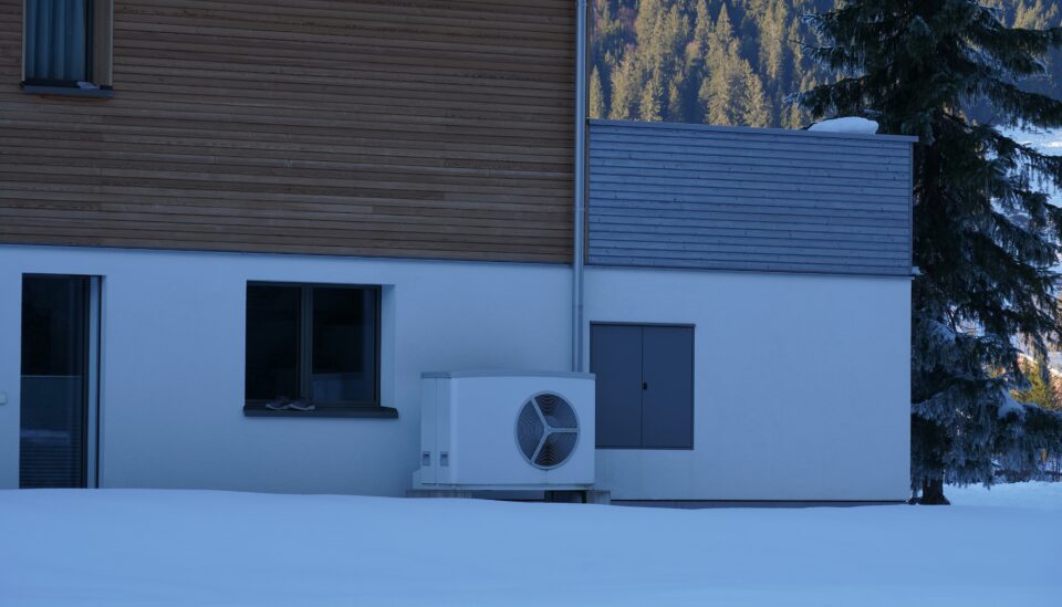

Every heat pump needs to accommodate defrosting, which is a completely natural process. Your heat pump runs its outdoor coil about 8°C below the air temperature.
If the outdoor coil is below 0°C, it will freeze the water in the air, causing ice to build up. Defrosting is most frequent in wet, cold conditions – especially when it’s foggy and around 3°C. Paradoxically, when the temperature drops below -2°C, defrosting occurs less often because there’s less moisture in the air, meaning ice build-up happens more slowly.
A heat pump defrosts by reversing the system, pulling heat out of the water in the house. If there isn’t enough heat in the water, the unit struggles to defrost. If this becomes a persistent issue, the heat pump may not fully defrost, turning into an ice block over time. This problem is caused by poor heating system design and inadequate software. The key to effective defrosting is ensuring the unit receives sufficient heat. The hotter the water in the radiators, the quicker and more effective the defrosting process.
