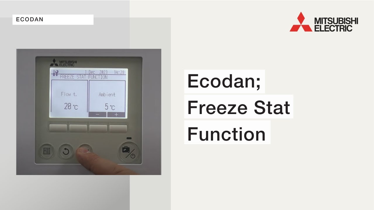

The pump running might be the Freeze Stat function. Depending on how it's set it comes on when the outside temp runs below a set level. It pumps the water round and heats it up if the flow drops below a certain level. It's easy to change or disable. Once again shout if you want to change and don't know how. Btw Freeze Stat it uses very little power.

@ggenergy It's all in here:
If you are turning it off then you should have glycol in the system to protect in the event of sub-zero temps (there is a danger that the water in the heat exchanger, in the outdoor unit, will freeze during periods when it's not running. Not to mention exposed, although probably insulated, pipes).
It's annoying there's not more flexibility in the temperature range for the freeze stat function. Seems entirely arbitrary given that you might be comfortable, knowing your glycol levels, having it only come on at, say, -5 outside temp etc.
