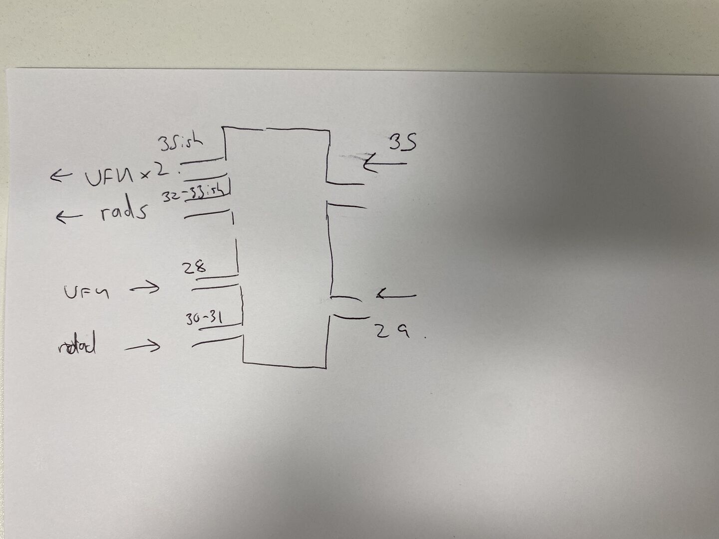

davidnolan22
@JamesPa
IMG 0743
The LLH is above, which typical max flow and return the system gets too.
Taking it out sounds like a plan, but a) I’m no plumber and b) the installer has to think its the right thing to do and want to take it out.
Yeah, the back up heater….. thats a funny one. As may sound like the simplest solution…. but, I didn’t sign up for that. I don’t really want a 3Kw 1:1 heater.  and you say the coldest days, yesterday in Sheffield was 0.6 ave temp, and I would have needed the heater for much of the day. Is that really that cold?? I don’t think so. They have already installed me 6 circulation pumps that I have to pay for, I’m not keen to add 60kw to the daily heating bill for any day that is close to zero.
There is no more insulation I can add.  I have been so anal about draughts.  had the window company come back so many times to readjust just anything if I felt I could feel a draught to check, I’ve been round with silicone gun, you name it I’ve done it.  I changed all the bathroom vents to expensive ones that stopped back draughts that cost me £500.  After seeing what I went through the builder and Plummers said there reluctant  working on another house with a heat pump. They warned me and I should have listened.
OK so feed to rads colder than feed to UFH and colder than flow temp from heat pump.  Not good, losing efficiency and thus oomph to building.  Taking it out will make a small difference, but maybe not enough to cover the problem.
Your ASHP isnt the problem so far as I can see, the problem is the UFH.  Without insulation it was always going to be an expensive madness to push probably 4kW straight into the ground, whatever heating you put on the back end.  If your installer was responsible for this then I would tell him to fix it, which involves digging it all up and doing the job properly (or something else, eg compensating you for the stupid build or at least putting in a backup heater FOC.
I presume that turning up the flow temp doesnt work – because the heat pump is already running at max power 24×7.
