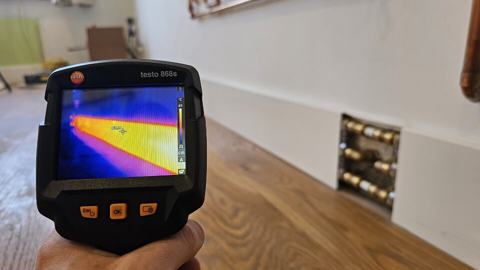

Add2Rad connects a short run of ThermaSkirt aluminium skirting heating in series with the existing radiator. A simple tee off the flow pipe before the TRV allows the ThermaSkirt profile to act as an extension of the radiator, boosting its output at low temperatures without altering the radiator itself.
In practice, 2-4 metres of discreet aluminium skirting typically supplies the missing wattage.
