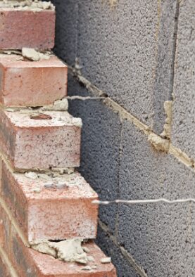

Since the 1920s, we have built houses with cavity walls, a 100-year-old cavity wall of brick, an air gap and blocks inside, as shown below. It has the same U-value as a 600mm solid wall, 1.6 W/m² K.
Filling the cavity with cavity wall insulation reduces this heat loss to 1.0 W/m² K, nearly halving the losses. That’s why it’s so popular; it makes sense and it’s easy to do.

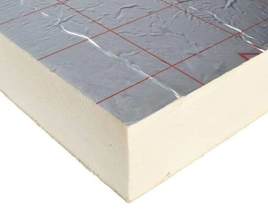

But it gets better. Celotex insulation is the stuff you buy in sheets covered in aluminium foil.
50mm thick Celotex has a U-value of 0.44 W/m² K. Or, to put that into context, 50mm Celotex lets only 1/4 the heat leak out, compared to a 600mm thick wall, and under half the leak rate of a cavity-filled wall.
The problem is it’s hard to slide sheets of Celotex between the walls in an existing house. The only realistic solution is lining the walls of your house with Celotex. It makes a huge improvement in the insulation and massively reduces the heating costs. It’s a great idea, but it’s not easy to do without disrupting the house decorations. But if you are renovating, it’s a very good idea to do it. And you can use it in the floors and ceilings to similar effect.
Nowadays, houses are built with a cavity filled with Celotex, normally 100mm thick. The total wall U-value is 0.18 W/m² K. That’s nine times better than a 600mm solid wall.
