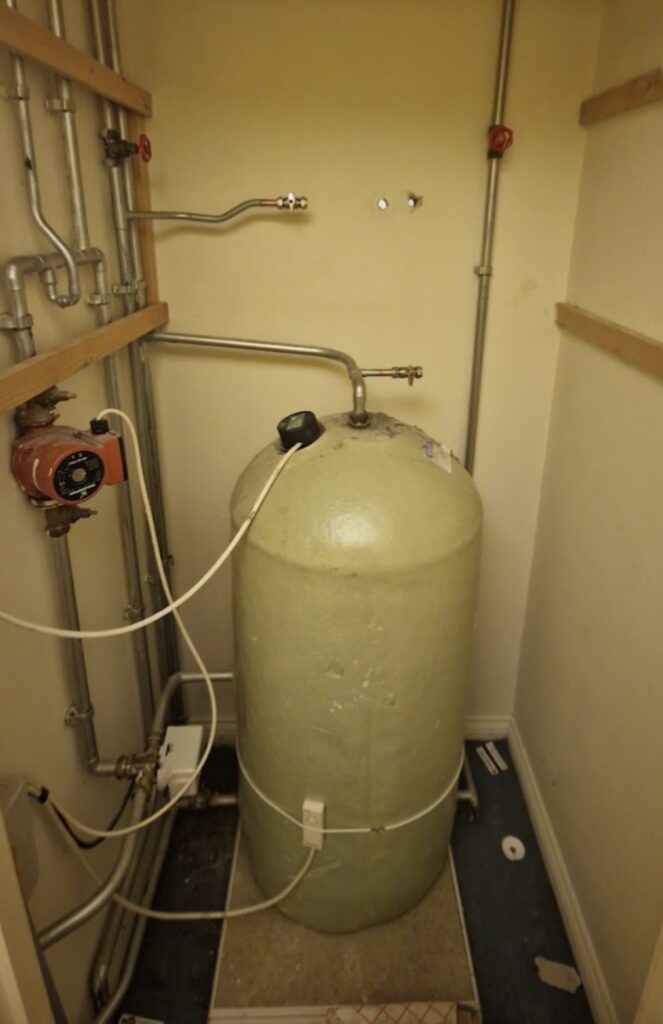

Most of the discussion focused on my pipework. I live in a timber-framed, well-insulated 2000-built semi-detached home. Two years ago, I added 300mm of loft insulation. The old boiler was fitted with primary pipework that runs from the kitchen to the airing cupboard and loft, where there’s a header tank. The pipework is 10mm microbore, which Octopus allows as long as it’s barriered, which mine is.

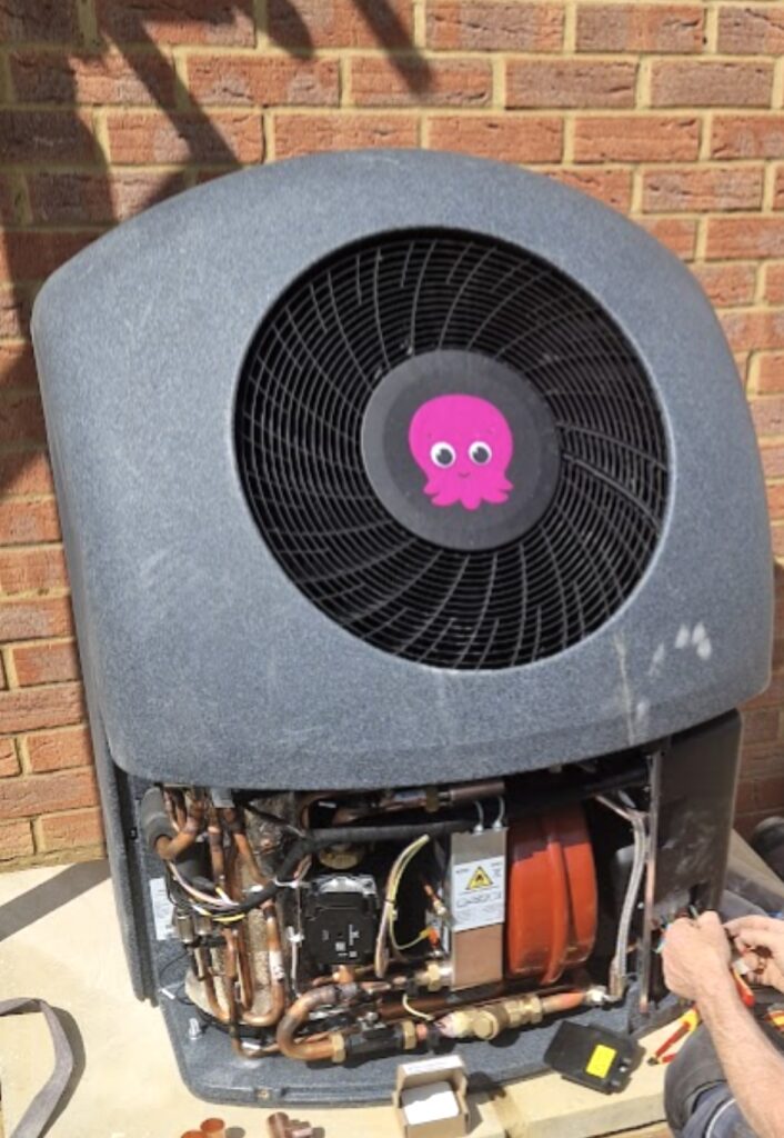

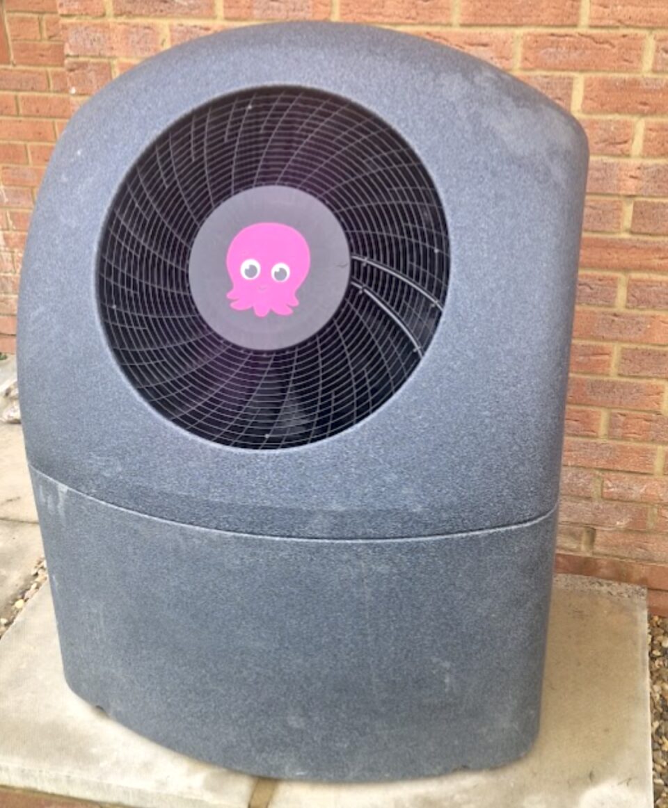

Planned for five days, the installation took six. A team of plumbers and electricians arrived on day one with all the required equipment. The ASHP site was prepared with a hard-standing base instead of a soakaway. My pump’s site is close to the garage wall, making for a very short external pipe run.

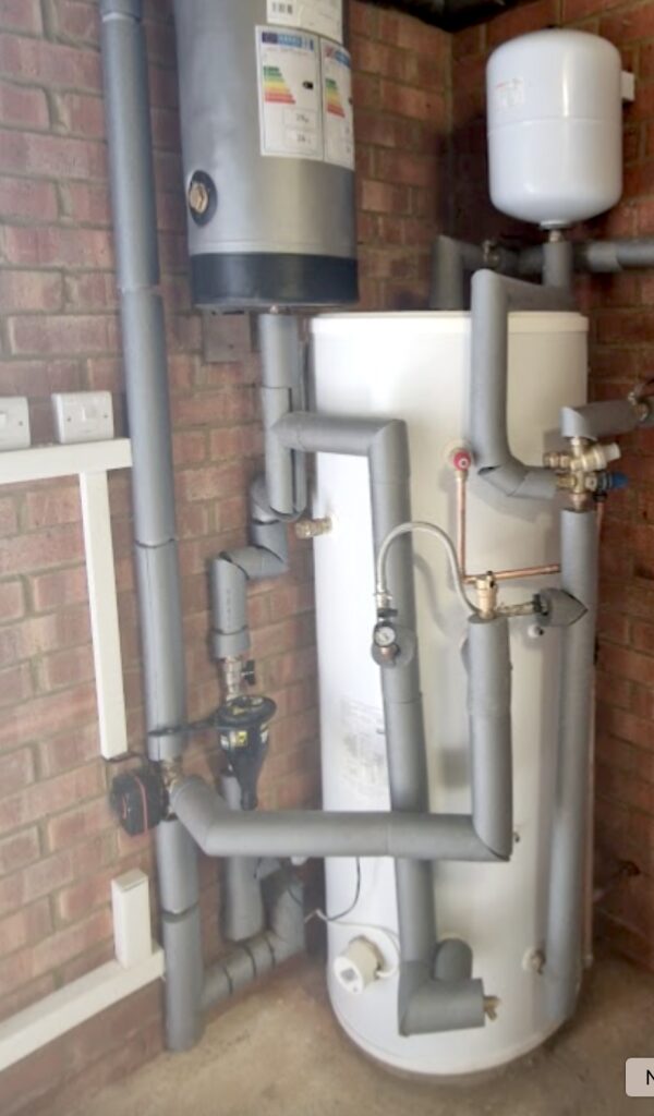

Inside, Octopus installed the DHW cylinder, a 26L volumiser, a Fernox TF1 filter, ESBE diverter valve, expansion vessel and a by-pass valve. In the airing cupboard, they cleared out the old system, making it available for storage. Octopus also took care of all the installation waste.

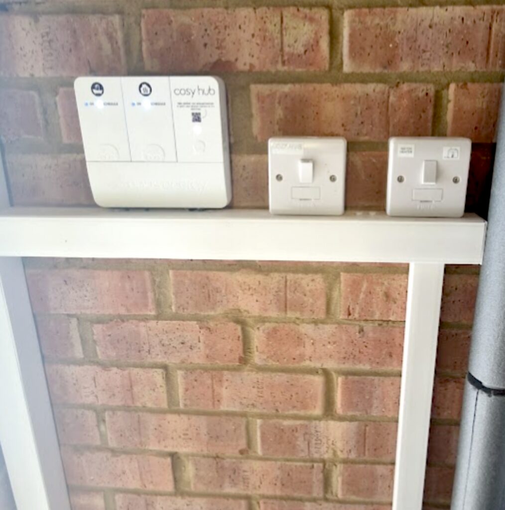

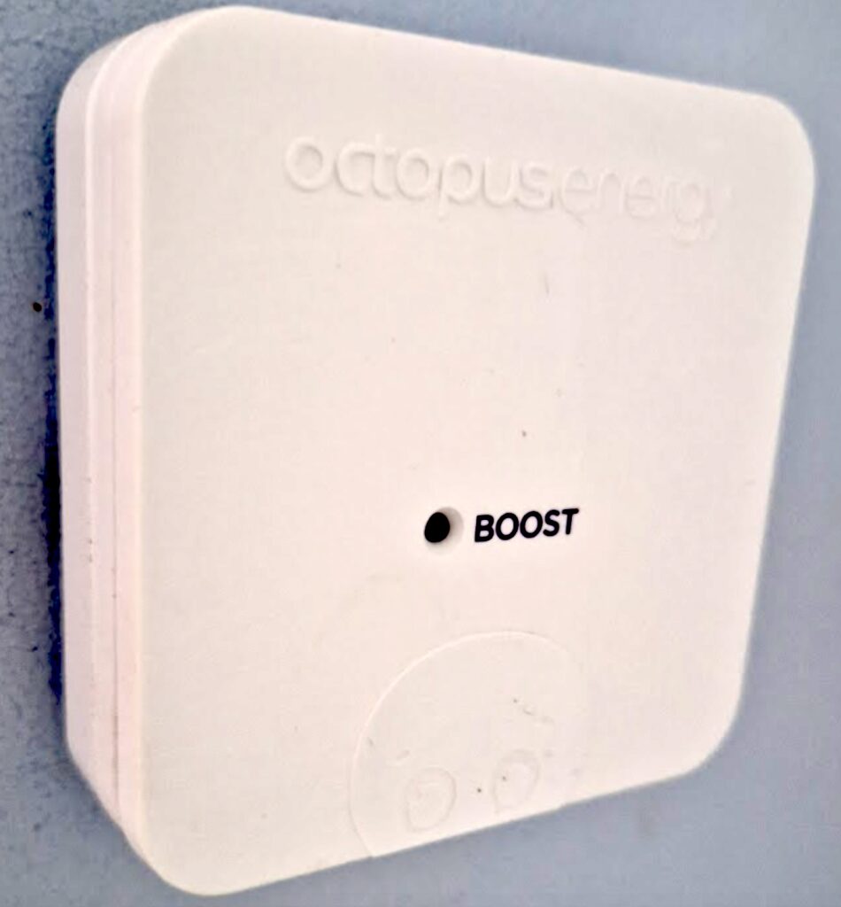

The system was completed with thermostat and humidity sensors (one per zone; I have one zone with two sensors). The small, wireless sensors are discreet and functional. The Cosy Hub, which connects to Wi-Fi, was set up quickly and is straightforward to use. Though the app currently has basic functionality, the system defaults to weather compensation, which has kept our home warm.

@wreckguru where was the heat pump finally installed, as in the final location?
@wreckguru so the actual heat pump is not sited near a door or window?
@wreckguru can’t say I disagree with your assessment and choices. Just for clarity in light in light of this article and journey, did Octopus ever give you advice on positioning?
