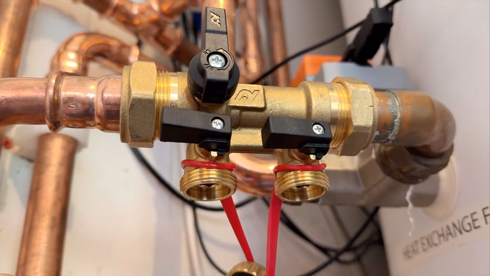

Fill & Flush Valve: This valve is a game-changer for commissioning. It enables a clean, controlled fill and purge of the system, ensuring air and debris are removed without risking damage to the heat pump’s internal heat exchanger.
