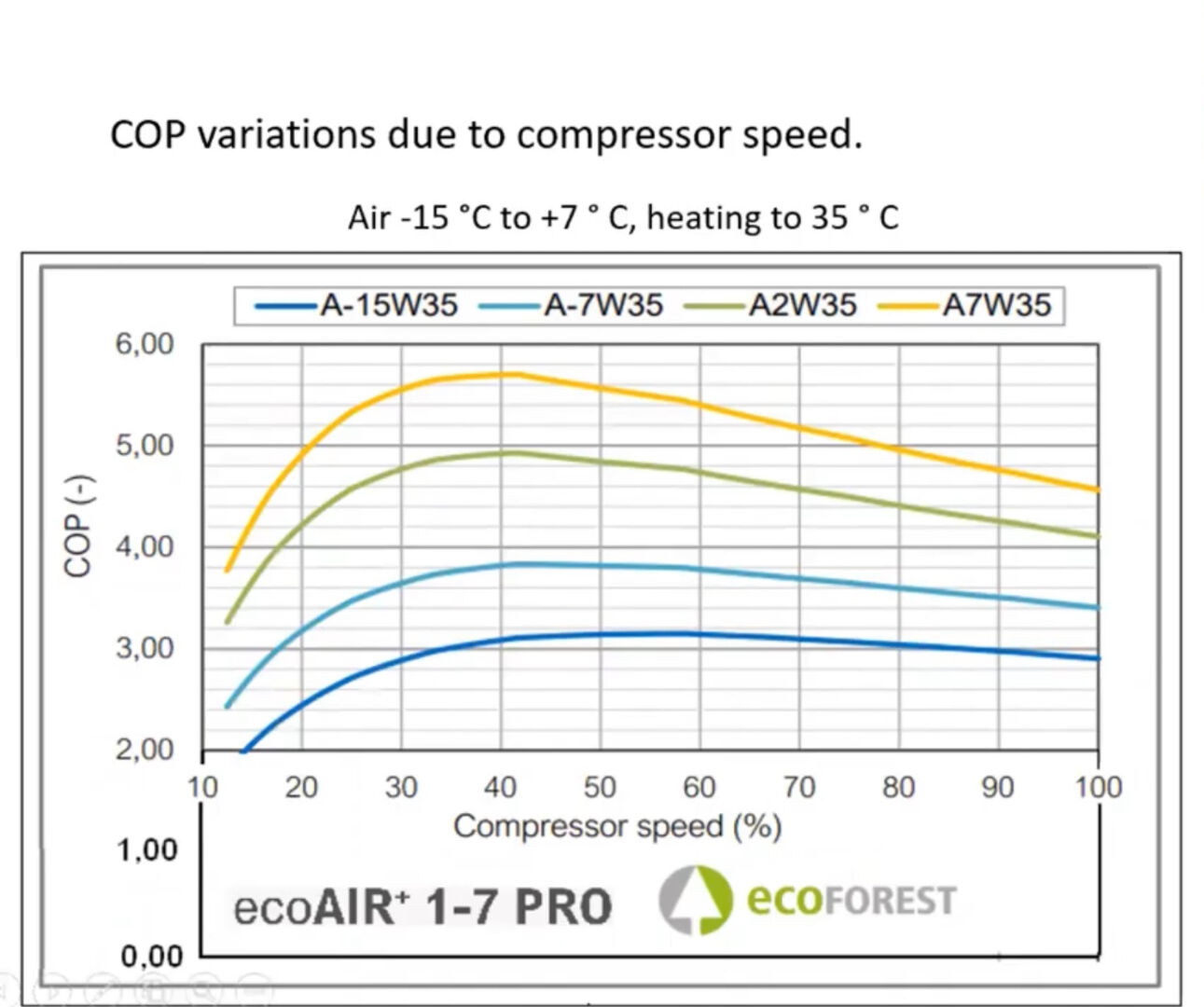

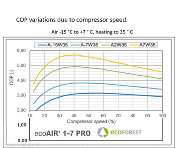

This output rating is very much of interest since a digitally altered HP may possess all the limitations of the higher output model such as minimum output operation. I believe this may be the case for the 6kw Mitsubishi which has similar lower output limit of the 8.5kw model.
another reason for knowing the true design output is relevant since it would appear that most of not all HPs appear to be operating at their best COP when operating at 40% level of output, with poorer COPs above and below that level. So how does anybody target their best output/efficiency level?
So the question becomes – 40% of what?
(info courtesy of @jamespa post of the John Cantor cop chart)

So in the above case the fact that HPs have a peak efficiency at a certain modulation which may be higher than the minimum output would be useful to know when anyone wants to set up a WCcurve.
Yet it’s not conveniently catalogued by most manufacturers in a format for homeowners literature so they can make use of it.
here is the chart from John cantors video on cycling which shows varying efficiency at different percentage outputs which I think is helpful.
