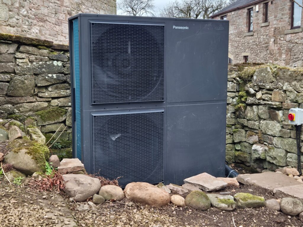

It’s always rewarding to complete a project and receive great feedback from a happy homeowner. This was the case with a recent installation of an air source heat pump in a solid stone property; one that many in the industry might have deemed unsuitable for a heat pump without a completely new heating system.
Here’s what the homeowner had to say:
“Our new ASHP system was installed in mid-January, and for the first time in 16 years, the house has been consistently warm – especially my home office, where even in mid-summer, I previously needed a pullover. We haven’t had to use the log burner in several weeks.
We upsized two radiators, relocated one, added a new one for thermosyphon and discovered that our underfloor heating valves were not fully functioning. Downstairs is a consistent 20–21°C, and upstairs 17.5–18°C when it’s 0°C outside.
The plant room has been returned to a utility room, which means everyone is happy.
Brendon and Jordan from Heacol have been with us throughout and have consistently stepped up to improve the system and resolve any niggles.
This included replacing the awkward inline filter with one in the plant room, adding open-source accurate monitoring and installing an interior thermometer so that the unit reacts to the house’s inside temperature rather than just the flow temperature. A communications issue with the outdoor unit required a temporary workaround, but this was resolved quickly.
The system is now accurately responding to both outside temperature and energy demand. Yes, this is a big house with a big heat loss (220m² @ 99W/m²), but we now have a system that works, and we expect running costs to go down compared to the two previous 16kW systems.
Thanks, Heacol, for working continuously to design, install, and refine the system.”

  • Heat Load & Flow Rate: The property’s heat load was calculated at 21kW. At a ΔT of 8°C, the required flow rate was 43L/min. The Panasonic M Series 25kW heat pump’s internal pump was able to achieve this.
  • Underfloor Heating: The system had only four circuits covering nearly 100m² of floor space. With a total flow rate of 22L/min (just over 5L/min per circuit), velocity was a comfortable 0.77m/sec. Friction loss was calculated at 8.86m head (86.86 kPa), which was manageable for the heat pump’s pump.
  • Radiator Distribution: The 25mm Pex-Al-Pex pipework supplied two manifolds. The first, located 7m from the plant room, served six of the nine radiators, requiring a peak flow of 21L/min with a pressure loss of 1.96m head (19.6 kPa). The second leg, serving three radiators, had a flow of 7L/min, with minimal pressure loss (0.26m head, 2.6 kPa).
  • Radiator Sizing: Two radiators were replaced. The largest and furthest was an Ultraheat 600×1600 6-column radiator delivering 2.3kW. Despite being supplied by 18m of 12mm Pex-Al-Pex, at a ΔT of 8°C, it required only 4.1L/min, with a friction loss of 5.19m head (51.9 kPa) and a velocity of 1.18m/sec (well within acceptable limits).
