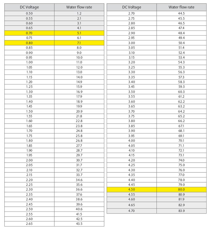

It will look like the image above. These things are almost indestructible and rarely go wrong. So, first things first: if you have a low flow speed alarm, it means you have low water speed. It does not mean the flow meter is faulty. Get that idea out of your head.
But if you are convinced the flow meter is faulty (it’s not), you can test it with a multimeter on DC voltage between the black and white wire. It must be plugged into the PCB and running. This is what you will find:
Note the yellow bit – this is where the flow meter will give you an alarm.
