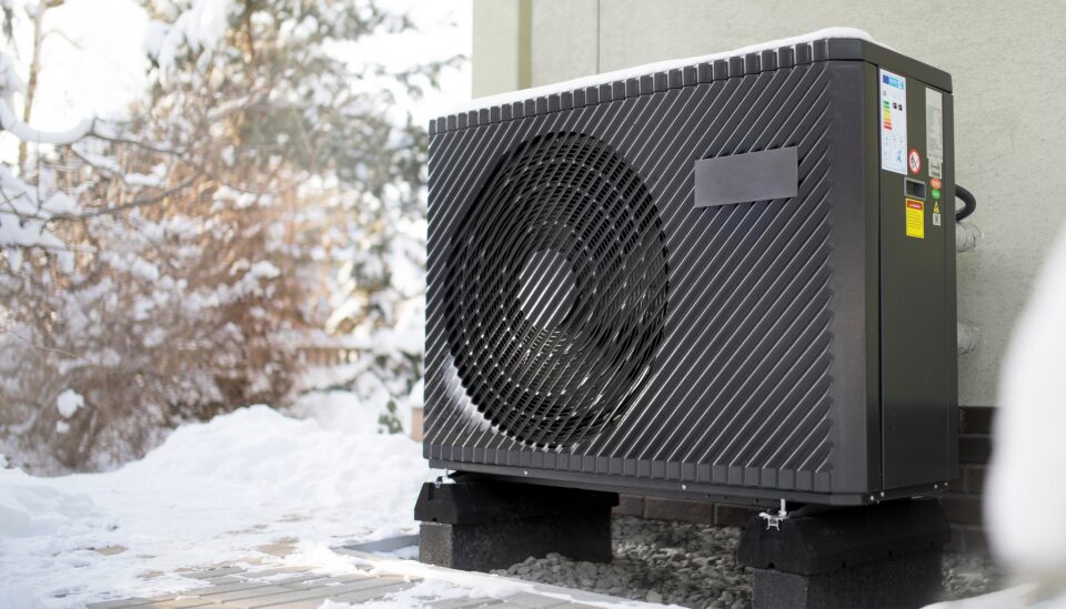

In the world of heat pumps, manufacturers and suppliers often warn us about the risk of units freezing up, which understandably causes a lot of concern. But is this panic really justified?
At its core, a heat pump is just a big box in your garden, connected to your home with water pipes that, if installed correctly, should be well insulated. The concern stems from the fact that water freezes at 0°C, and when water freezes, it expands with enough force to split pipes or damage components within the heat pump. Naturally, no one wants to deal with that.

Most modern heat pumps come with built-in freeze protection. Here’s how it works.
When it’s cold outside, the heat pump is usually running, so the pipes stay warm and there’s no risk of freezing. But if the system is off (say, because you’re away on holiday), and the water inside the unit drops below 10°C, the heat pump and circulation pump will automatically start to keep things warm. This is stage one of freeze protection.
Stage two kicks in when the ambient temperature drops below -2°C. At this point, the circulation pump runs constantly to keep the water moving, because moving water is harder to freeze. As long as the power stays on, the system can look after itself.
But what happens if there’s a power cut? If temperatures drop below freezing and the power is off, the heat pump can’t protect itself. This is where antifreeze or antifreeze valves come in handy.
