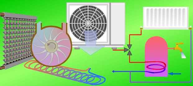

component parts of an ASHP
The refrigerant enters the collector (the radiator grill) as a fluid and picks up heat from the air-stream. As this passes through the compressor, the increased pressure causes the temperature to rise further. Within the heat exchanger unit, that energy passes into the surrounding water, causing the refrigerant to condense, and the cycle repeats.
