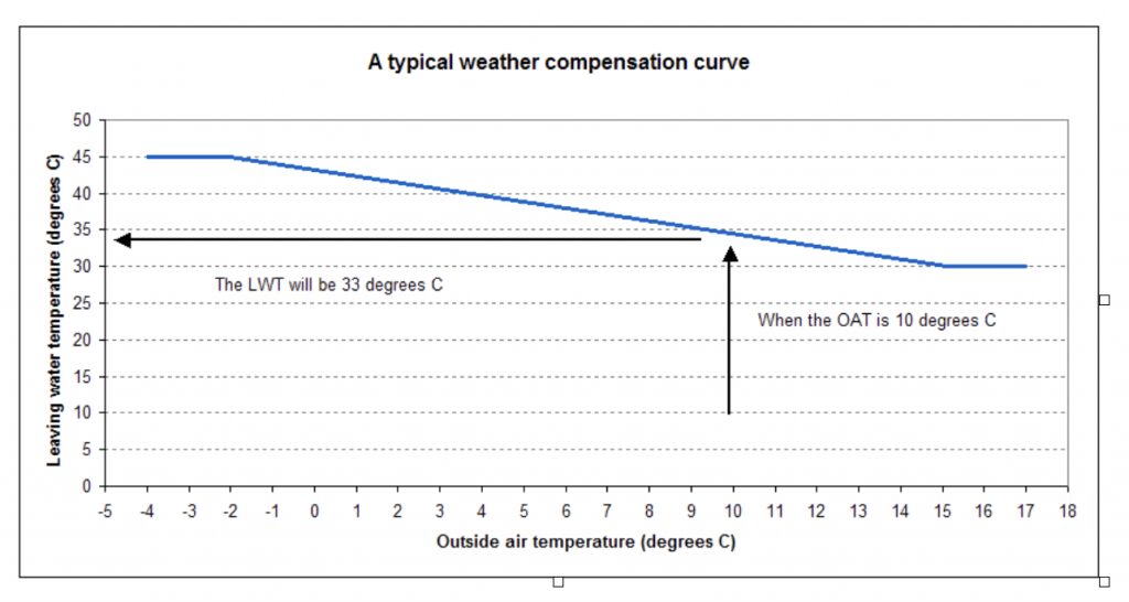

If we don’t use timers and thermostats to control heat pumps, how do we control them? We use something rather neat called Weather Compensation (some manufacturers give this a different name, e.g., Samsung calls it ‘Water Law’, but it is the same thing).
Weather compensation works by adjusting a heating system’s leaving water temperature (LWT) according to the weather, specifically the outside air temperature (OAT). Given that the major day-to-day determinant of heat loss, and therefore heat demand, is the OAT, why not simply regulate the LWT according to the OAT? When it is warm outside, heat loss (and therefore demand) is lower, so the LWT can be dialled down. When it is cool outside, heat loss (and therefore demand) increases, so the LWT is dialled up.
By adjusting the heat pump’s output according to the OAT, we closely match the actual output to the demand. It does take a bit of trial and error to get the settings right (because all homes vary, there are no absolute guidelines – see below), but once set up, weather compensation will seamlessly ramp the heat pump’s output up and down as needed, keeping the inside of your home at a steady, comfortable temperature. It acts as a sort of autopilot for your heat pump, automatically adjusting the throttle according to demand. KISS – what could be simpler than that? It cannot be emphasised too strongly that, for perhaps 90% of homes, weather compensation is all they will need to control their heating system.
Because all homes vary, setting up weather compensation, as noted above, does require some trial and error to get it spot on. Competent installers will normally apply a best-guess set of settings (called the weather compensation curve, or WCC for short) at installation but will leave it to the homeowner to do the final tweaking. This typically involves setting the endpoints (the extreme left-hand and right-hand ends) of the WCC to match the home’s heat demands. Your installer, your heat pump manual, or even the forum are good places to look for instructions on how to access these settings.
Typically, this involves setting the low OAT (left-hand) end and the high OAT (right-hand) end, and then, for each of these OATs, setting the LWT (the temperature of the water coming out of the heat pump) to a suitable level. For example, in a typical installation with radiators, the low OAT end of the weather compensation curve may have the OAT set to -2°C, with the LWT set to 45°C, while the high OAT end of the curve may have the OAT set to 15°C, with the corresponding LWT set to 30°C. This means that at -2°C OAT, the LWT will be 45°C, and it will then steadily decrease as the OAT increases, until the OAT reaches 15°C, when the LWT will be 30°C. A WCC can be shown as a graph, and one with the above settings will look like this:
A typical weather compensation curve. Your heat pump constantly monitors the outside air temperature, and then sets the leaving water temperature depending on the outside air temperature
Once you have mastered how to set the weather compensation curve (WCC), run the heating for a few days and observe how the indoor air temperature behaves. If the home is running a little too warm, lower the WCC leaving water temperature by a degree at each end of the curve and observe again for a few days. Over time, through trial and error, you will gradually tweak your WCC until it keeps your home at a comfortable temperature most of the time, without needing daily adjustments.
