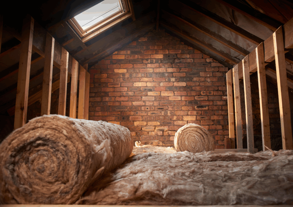

Let’s address the obvious: no one disputes that insulation is important. Insulating lofts, draught-proofing and cavity wall upgrades where possible are all low-hanging fruit and worthwhile measures, and are important irrespective of your heating source. But this idea that you must comprehensively upgrade your insulation before you even think about a heat pump is not only false… it’s actively damaging.
