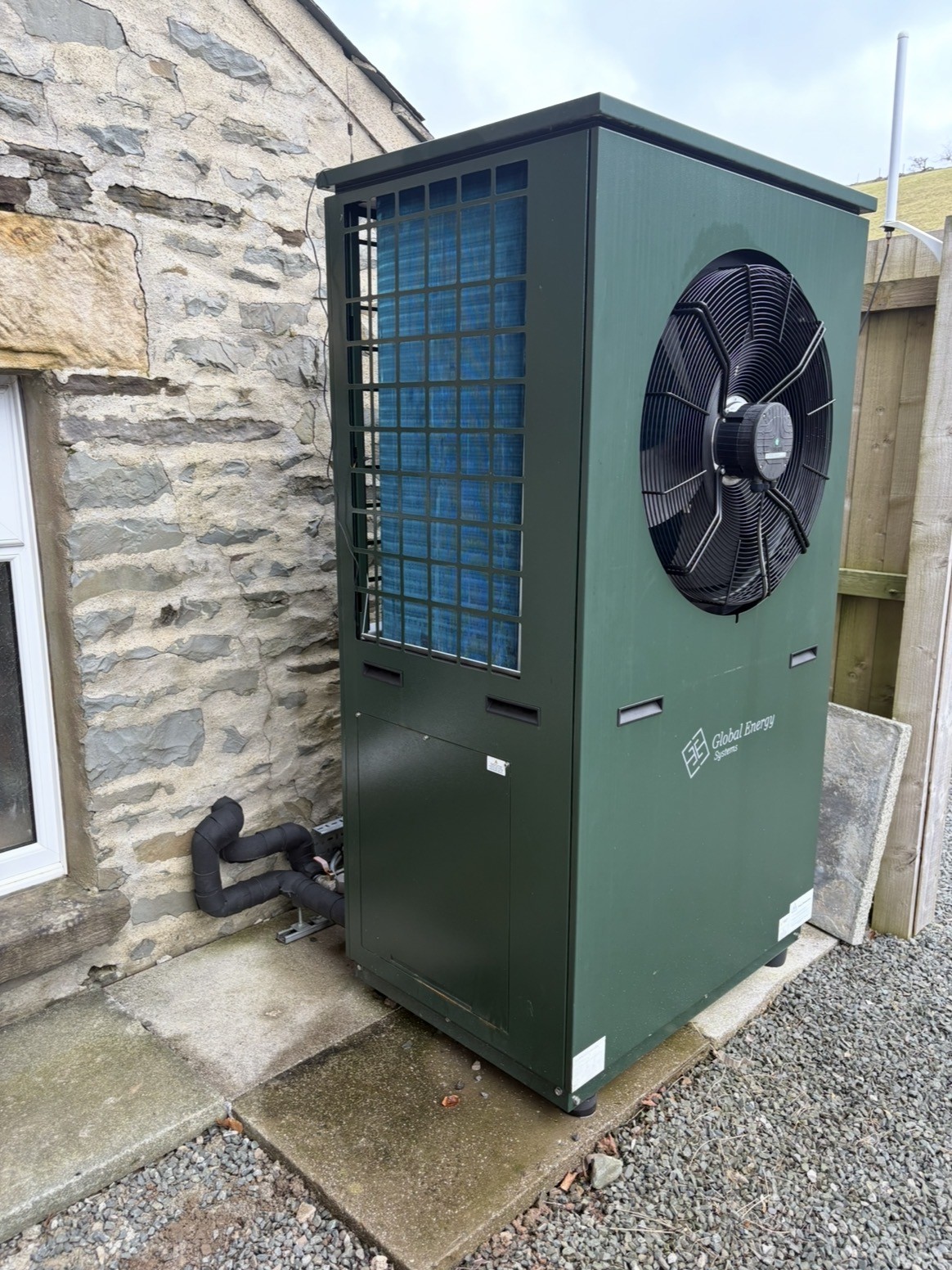

Onto our issues. We live in a five-bedroom detached house in rural Cumbria, about a mile inland and roughly 200 feet above sea level. We have no access to mains gas (oh, how we wish we did) and the property is supplied via an overhead electricity line. The previous owner used oil central heating.
The house has 11 radiators in total. Apart from two bathrooms with towel rails and a kitchen with a newer single-panel tall radiator, all other radiators are dual-panel and typical of a high-temperature oil system. Two rooms, in a sandstone section of the house, have no wall insulation but are double-glazed. The rest of the house has cavity walls. In 2025, we installed 300mm of loft insulation throughout the property.
The system is a Global Energy Systems Thurso heat pump, paired with their specified UK-made World Heat CLIMACYLSS dual tank, containing 300 litres of hot water and a 100-litre buffer. A separate pump feeds the radiator circuit via approximately 22mm pipework running the length of the house through the attic, with 15mm drops to the radiators. There is a single heating thermostat in the hall.
The previous owner (let’s call him Joe) wanted a heat pump. He knew installation was expensive but believed it would save him money in the long run. We know this because we had many conversations with him before and after buying the house, following his sad and costly divorce which forced the sale.
Joe approached Mitsubishi, who told him he would need a proper heat loss survey and that most, if not all, of the radiators would need replacing. “Bugger that,” Joe thought. He knew central heating, and with oil the radiators were always hot.
Joe then discovered Global Energy Systems. According to Joe, Global Energy told him there was no problem. No heat survey was required. They referred him to one of their installers, and the Thurso model was recommended. Although the output was significantly lower than Mitsubishi had suggested, Global Energy said the Thurso would be fine. Joe accepted this advice and ordered the system. He lived with it for around three years before selling the house to us.
Global Energy charged £360 per year for an annual service and electronic monitoring. The system transmits mobile data back to them, allowing remote monitoring and adjustments. Customers have access to a summary page, but when using external control (a thermostat), you cannot remotely turn anything on or off.
Global Energy do not permit customer access to system settings. We are not allowed to adjust flow temperature, enable weather compensation or change any other parameters. All we have is the hall thermostat.
It later became apparent that the system is set to a fixed “flow” temperature of 45C, except the system is so badly under-sized that it is incapable of reaching this through the radiators, even on mild days. Most days it cannot even reach 31C.
What actually happens is this: every time the thermostat turns off, the system continues running in order to heat the buffer tank up to 45C before going into standby. This cannot be stopped. The radiator pump runs for around five minutes, then stops, after which the heat pump typically runs for another 25-30 minutes heating the buffer tank. Only then does the system shut down.
This is where things become absurd. 45C is clearly far too much for this system, particularly in cold or damp weather and it triggers multiple alarms every day. The manual provides no explanation, but the alarms include:
  • Envelope Tc Low
  • EVI High Superheat
  • Inverter Overcurrent
  • Compressor Alarm (often twice in succession)
  • Lost Rotor
The system usually shuts down for around ten minutes to reset itself. By that time, the thermostat has often called for heat again, and the entire cycle of doom restarts. Occasionally (particularly in damp weather around 3-7C) the system also throws a “Major Defrost Failure” alarm and shuts down completely.
This happened while we were away on holiday. We returned to a bleeping alarm and no heating, requiring a manual reset. During that period another water pipe froze and burst, flooding the house and costing us thousands in re-carpeting and redecoration. I cannot hold Global Energy responsible for this, but I do wonder whether that pipe would have failed had there been heat in the house.
We now rely on a jury-rigged setup of industrial fan heaters in the lofts, connected to Wi-Fi smart plugs and temperature sensors. If we are away and receive an alert that attic temperatures are nearing zero, we can switch heaters on remotely from anywhere in the world. But should any homeowner really have to live like this?
Global Energy have never contacted us to say they identified any faults. We, however, have contacted them many times. On one occasion they replied with a vague and useless suggestion along the lines of “try turning it off and on again”. After that, we emailed twice more and received no response at all. We telephoned and spoke to a lady who said nobody was available but she would make a note. Nobody ever called back.
We requested access to the system settings so we could attempt to manage it ourselves. They declined to engage. My builder contacted them, and so did his plumber, both without success. Neither was given access to the system or meaningful support.
This system is effectively useless. Customers are completely locked out, and it now needs replacing… likely along with all the radiators. Frankly, it is junk.
There was also a serious manufacturing fault. The external evaporator fins overhang the casing on the left-hand side, allowing condensate to run down between the panels and into the machinery below. Directly underneath sits the booster heater, with wiring on top, and below that the internal water pump.
The booster heater failed early on, so early that Joe did not even realise there was a booster. After we bought the house, the water ingress then destroyed the internal water pump. Global Energy charged my partner around £800 to replace it. They did replace the booster heater free of charge.
The booster remains active up to 30C, and we are not allowed to change this setting. Our only option is to turn off its circuit breaker when desired. Recently, the booster alone has accounted for roughly a third of the total electricity consumption. Global Energy did not identify the overhanging fins as a fault; it was left to me to bend them back manually to stop the water ingress.
The annual service itself was minimal. The specification includes cleaning the evaporator tray, yet a dead mouse remained there after the service. The engineer, wearing a Global Energy polo shirt, clearly did not even remove the front cover. This is disgraceful and, in my view, a discredit to the industry. We eventually cancelled the annual contract and have been on our own ever since.
